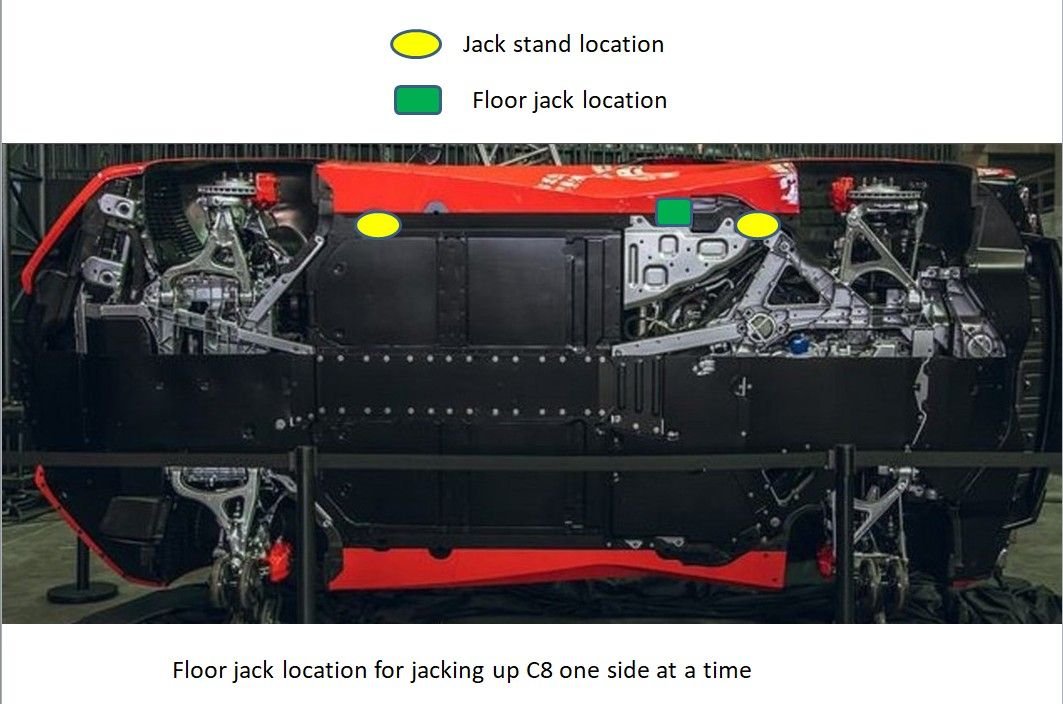

I recently saw a video from Paragon that shows someone lifting their C8 from the circular holes near the rear of the car, then placing jack stands where the pucks are located on the oval slots.
Has anyone else tried this with success?

That is the way I normally lift the car when using jacks and jack stands.

Should not be an issue. both locations are located on the frame rails.

That's the right way, the easy way to lift one side at a time.
Is that green spot where the round hole is in the frame?

Post 4 / C5Racecar has a good photo.
Jacking these cars has been a discussion.
I have yet to lift and support on 4 jack stands.
I use my installed jacking pucks for the jack and then place Race Ramps under the tires.
Having two jacks (for lf & rt sides) can be an asset
Removing the undercarriage panels to access GM's specific jack-stand support area is PIA.
So having a jack location in which you can also place the jackstands on the pucks is awesome.
Post 4 is a great answer, again, jacking these cars is a discussion.
