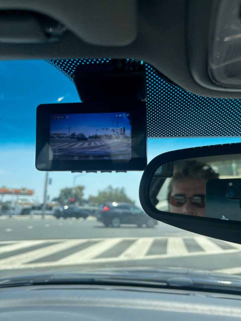

The one I installed on my last car was a 2-channel kit with the main dashcam that I mounted to my windshield (peal and stick double backed foam tape) to the left of the rearview mirror. It had a power cable that I routed across the top of the windshield down the right side, and where the bottom of the windshield met a crease that went into the door jam, and hung a left under my glovebox and then to my cigarette lighter. There was a another wire for the rear cam that plugged into the main unit, and I routed it similarly but routed it where the carpet met the vinyl side pieces. Then back up laong the side of the rear right-hand seat and along the top back, then free run a few inches to meet the rear cam stuck to the back window just above the center brake light. Amazingly, the power and rear camera cables were exactly long enough, and almost completely hidden except the few inches at the rear camera and the power receptacle.
Anyway, these kits come with a plastic tool for wedging the wiring, I didn't need to unscrew anything. it wasn't an expensive camera, and of course you can get 3-channel if you want to record the interior of the car too. I didn't particularly identify this camera as fitting my needs, it just popped up on Vine (I'm a reviewer) as being available (I get a 1099 at the end of the year for the retail value for income tax, but otherwise it's free). The timing was perfect because my car had been hit from the rear side and along half my car by a lady who told insurance that I lane changed into her. Fortunately the arbitrator didn't buy her story, it was visually obvious, but it made me want a camera and luckily one popped up that worked out.
Anyway, I was in the high-end car stereo biz (selling) as a young man, and car interiors are designed to hide wires. So there's usually nothing tricky. If I put in a system, I'd stick rear cam probably low middle of the back window (could be low or high, but low is probably where the wires will be the easiest to hide. The front cam would be high as practical, to the left of the rearview so you cn easily look up and adjust it, and see the video in real time. I havenm't looked at it closely with installation in mind yet, especially with the battery issue from day 1 that just got cleared yesterday. I have an SD car, I think I put it in now and see what the built-in PDR does for me first.
In the pic, you can see the wiring just tucks under the headliner of my Acura. It may look like it takes up a lot of room, but you can see it's a smll fraction of the size of the rearview. Also, they aren't terribly expensive, easy to remove as long as it's in place where you can scape the sticky stuff of with a razor blade (or use acetone or other solvent). And if you're Prime you can probably return it if you pull it out and size it up and you don't like it.
