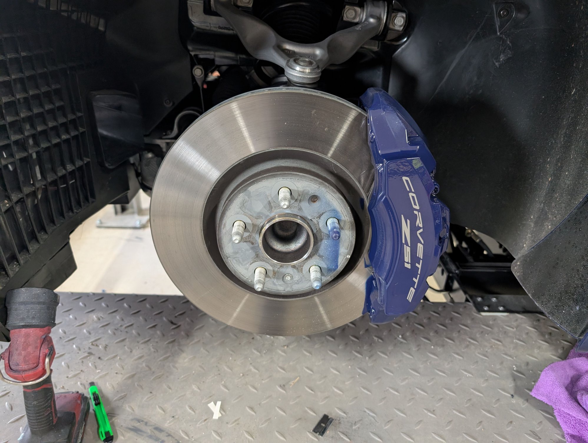

What's the better way to go...painted calipers, or powder coat?

I have owned vehicles with both painted and powder-coated brake calipers and observed no measurable difference in durability or wear characteristics between the two finishes; both performed equally well over time. One key advantage of conventional high-temperature caliper paint is that the caliper assembly can remain intact during refinishing—there is no requirement to remove the pistons or internal seals.
Powder coating, by contrast, requires curing the coating in an oven at elevated temperatures. Exposure to these temperatures can compromise elastomeric components, so the calipers should be fully disassembled and, at a minimum, all seals replaced. This additional disassembly, resealing, and reassembly increases both labor time and parts cost, which can significantly raise the overall expense of powder coating.

I have a buddy who was a career metal worker and did both processes in his career. He told me in durability and finish both are the same. The difference he noted was when painting prep time is everything, but if that step done right painted will be just as good. With calipers I preferred painted as I could do it on car without removing the calipers. I used paint specifically produced for heat/calipers. I normally sprayed, but even used the self leveling brush on as well. I unbolted the calipers and hung on wire to paint.....

How did you do the lettering?

Decals in a variety of colors are available from several vendors on Ebay. Here's another thread with info on painted calipers...
