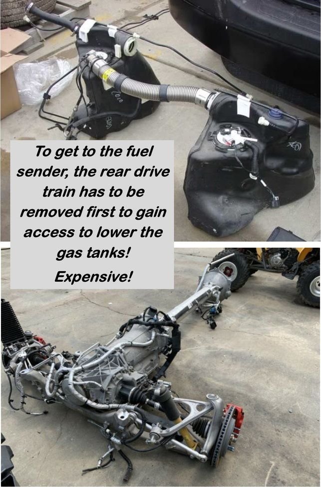

Started with my 1st of two C7s and continued for my two C8s. It's still listed in the 2025 Owner's Manual. Gal with a C7 who always used Top Tier Gas had her furl sender read erratically. Dealer installed two bottles of the GM fuel treatment, Solved the issue.

When that gal with the C7 had ~100,000 miles she had to have the fuel sender replaced. Don't think this Pic is from her, but she mentioned the drivetrain having to be lowered. In the C7 to replace the sender (which is not that expensive), because of the large hose going from the left tank to right side tank the WHOLE DRIVETRAIN HAS TO BE REMOVED TO DROP THE TANKS. Not sure what the procedure is for the C8. So just in case I add. And it does help keep the injectors clean.
