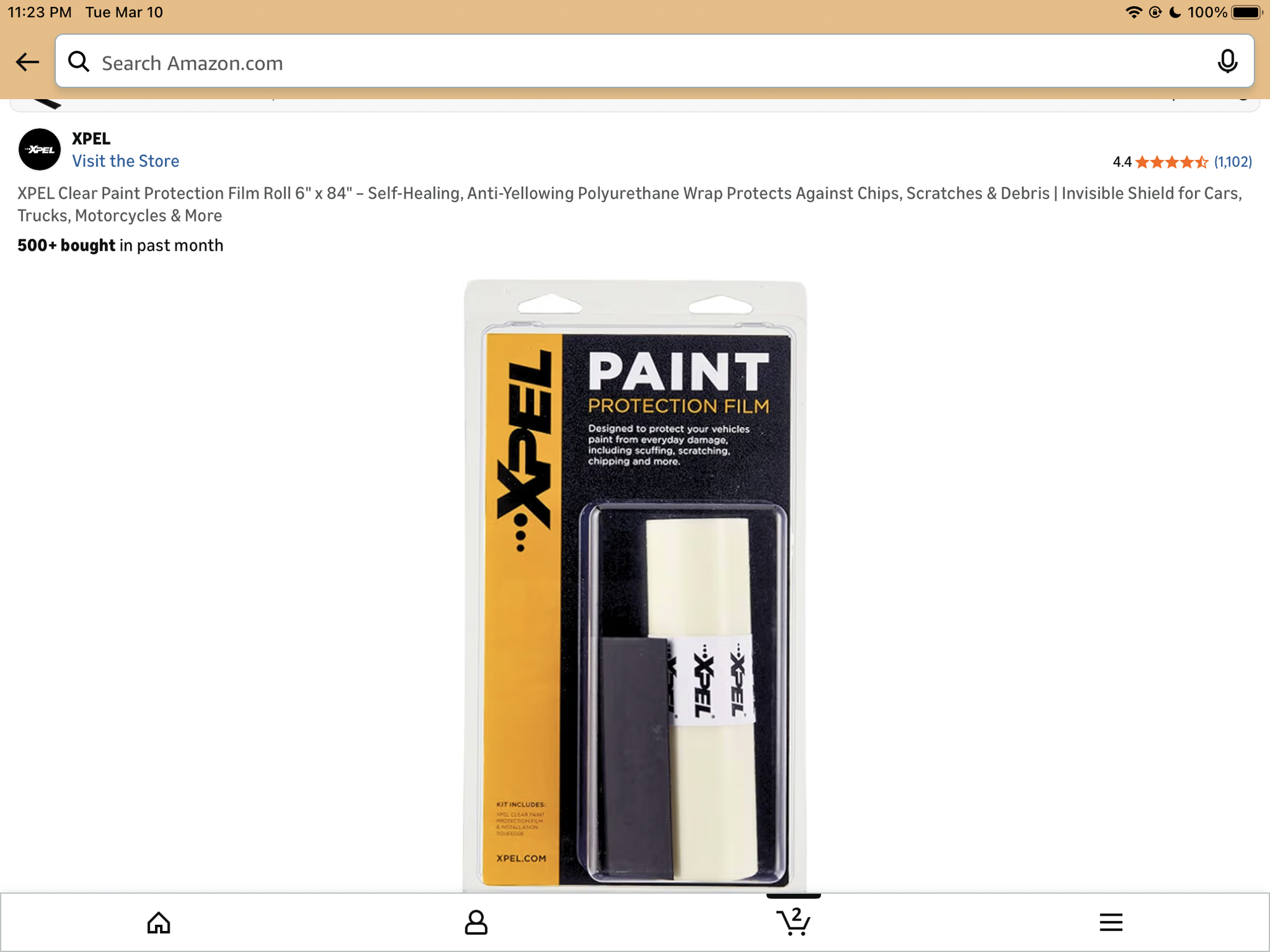

Is it this

That's not exactly what you want. That is only 6" by 7 feet. It used to come in 100 or greater foot rolls.
OP, I see 3M PPF available in 6" by 100 foot rolls on Amazon. That should be a good substitute. 8 mil thick.

this is definitely not what I’m looking for as far as size wise. The last time I used 12inches x 40feet and it wasn’t quite enough

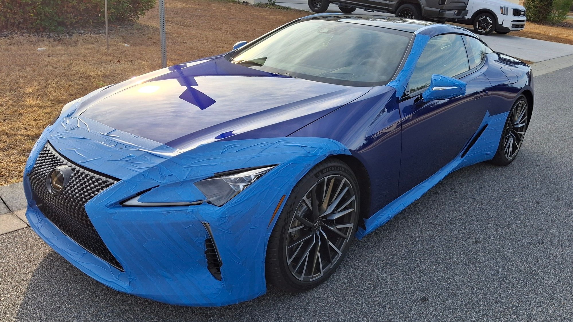

Not sure how much that tracwrap stuff costs... I did blue painters tape for a 1500 mile drive home in my LC. Three small (tiny) rock chips managed to get through to the paint (2 on hood, 1 on front bumper) which isnt bad for 1500 miles and I hardly notice them with the PPF on now. Pretty sure all 3 happened in the 1st hour in bumper to bumper traffic in Miami.
It only cost me $20 on Amazon for three 55 yard rolls of 3" wide tape. Took a little under an hour to do this prior to driving. Had to oull over a couple times when a piece or two began coming loose due to wind, but nothing too bad and a quick "fix" each time. 3 rolls was just about right still have a little left. You could even do it 2 layers thick if you wanted thicker protecrion if driving through high traffic areas, for total cost $40.
i'm sure the 8mil PPF would be better than the tape, but I didnt want to try and get it through airport or put it on by myself.
Here's what I used:
Amazon Amazon
Here's what folks saw passing them on I10 from Miami to TX:

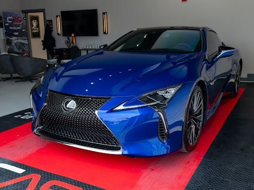

Here she is post PPF, almost flawless paint despite the drive.
