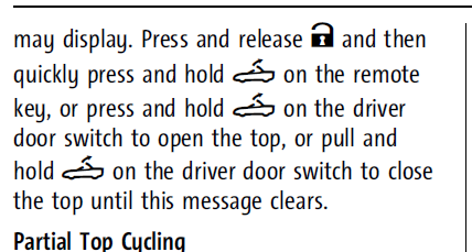

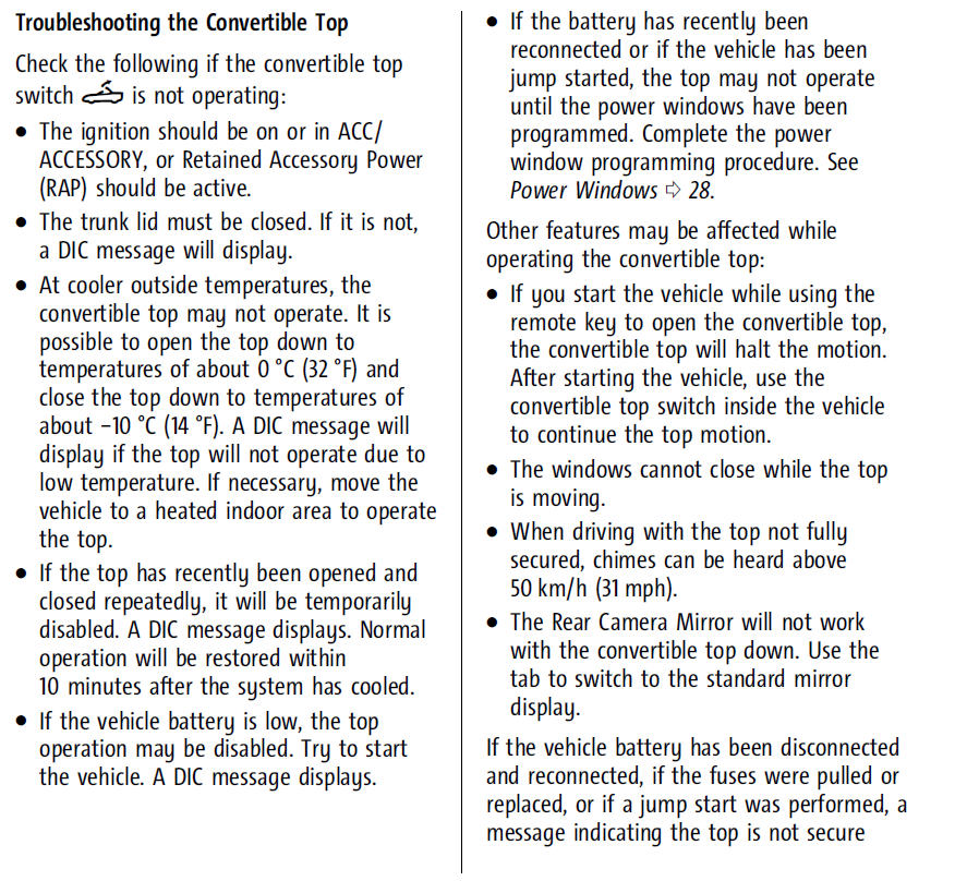

Maybe double-check the trunk and/or try opening the trunk and close it again, in case the car thinks the trunk is open for some reason. Has the battery been changed recently?
If of any value, from the manual:

Ok this may be way off base, but isn't there a temp sensor that stops the top for opening when the temp is below a range….?
