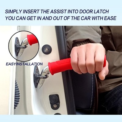

Get a car cane.........
Car Door Handle for Elderly, Stand Assist Support Bar for Safer Entry & Exit - Picture 1 of 6
Old Today | 12:03 PM
EvanD's Avatar
EvanD
CF Community Team
Joined: Nov 2005
Posts: 5,244
Likes: 2,886
From: Charlotte N.C.
Won't work with the C8.
To Entry/Exit Ease, Issues, Aids
