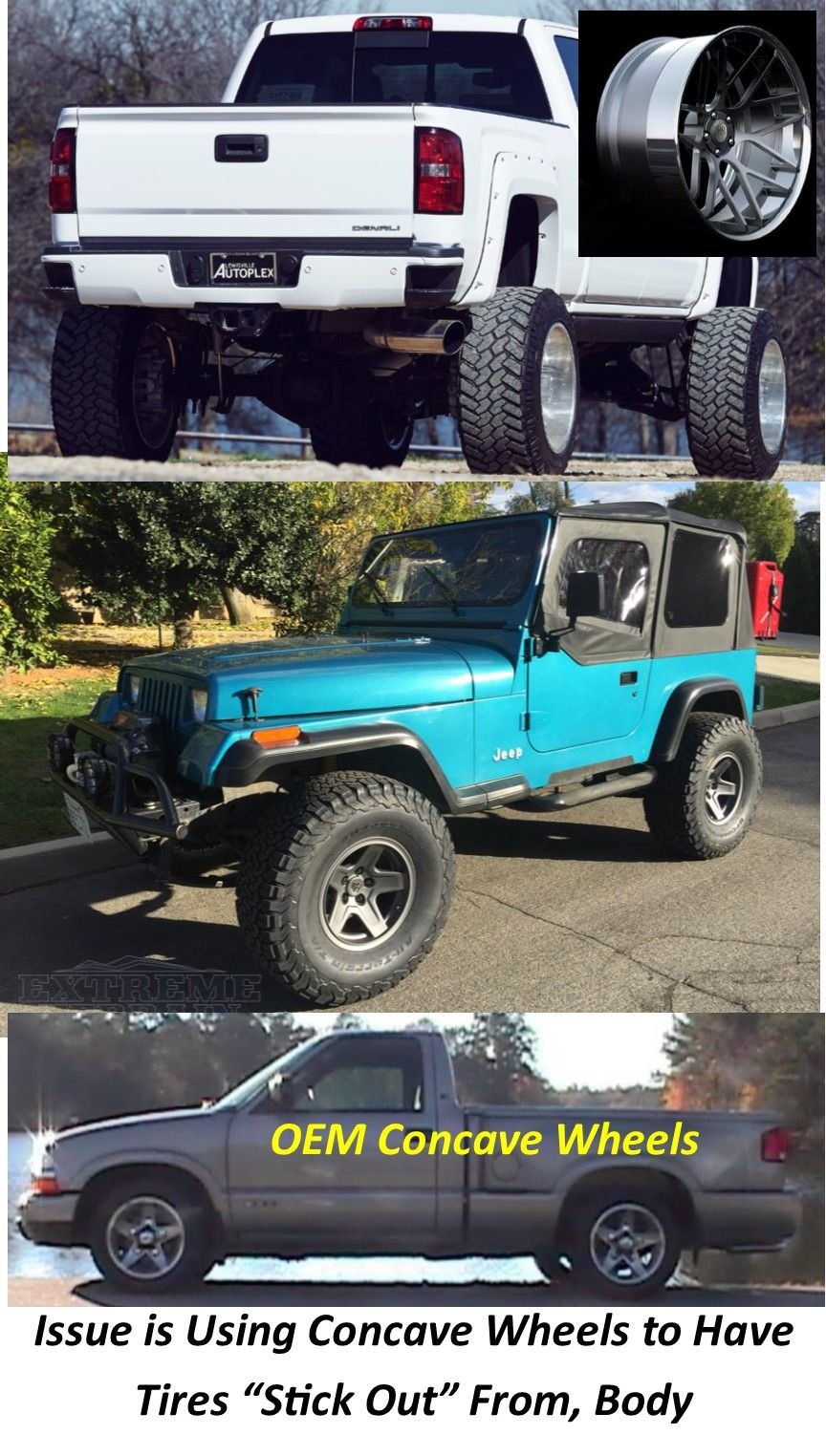

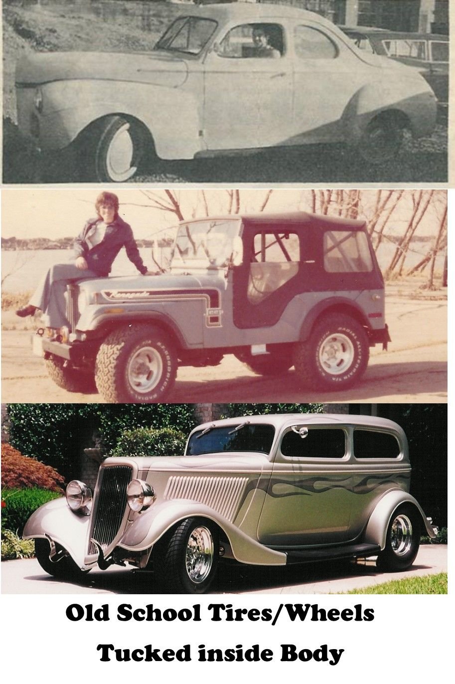

Believe the issue is using "Concave Wheels" so tires stick out from the car. Versus "Old School" where tires are within the body, loading the wheel bearings properly and handling as the car/Jeep/Truck was designed. Could be wrong and maybe folks are looking for something else???
My Street Rod has concave back wheels but the offset is proper for the 13 inch wide wheels/420 section tires in a tubbed chassis. My S10 OEM wheels were concave but again have the tires inside the body and wheel bearing loads and handling as GM designed.
See a lot of vehicles with tires "sticking out" around here. The white truck pic is similar to my neighbors son! Assume he thinks It looks good. I think it's hilarious!
Corvette Wheels with Proper Offset and tires inside fenders or Spats (where needed)

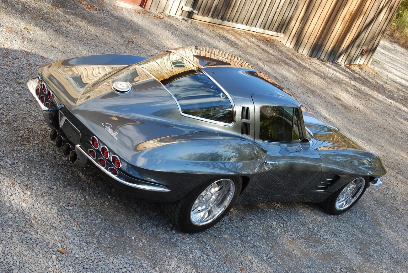

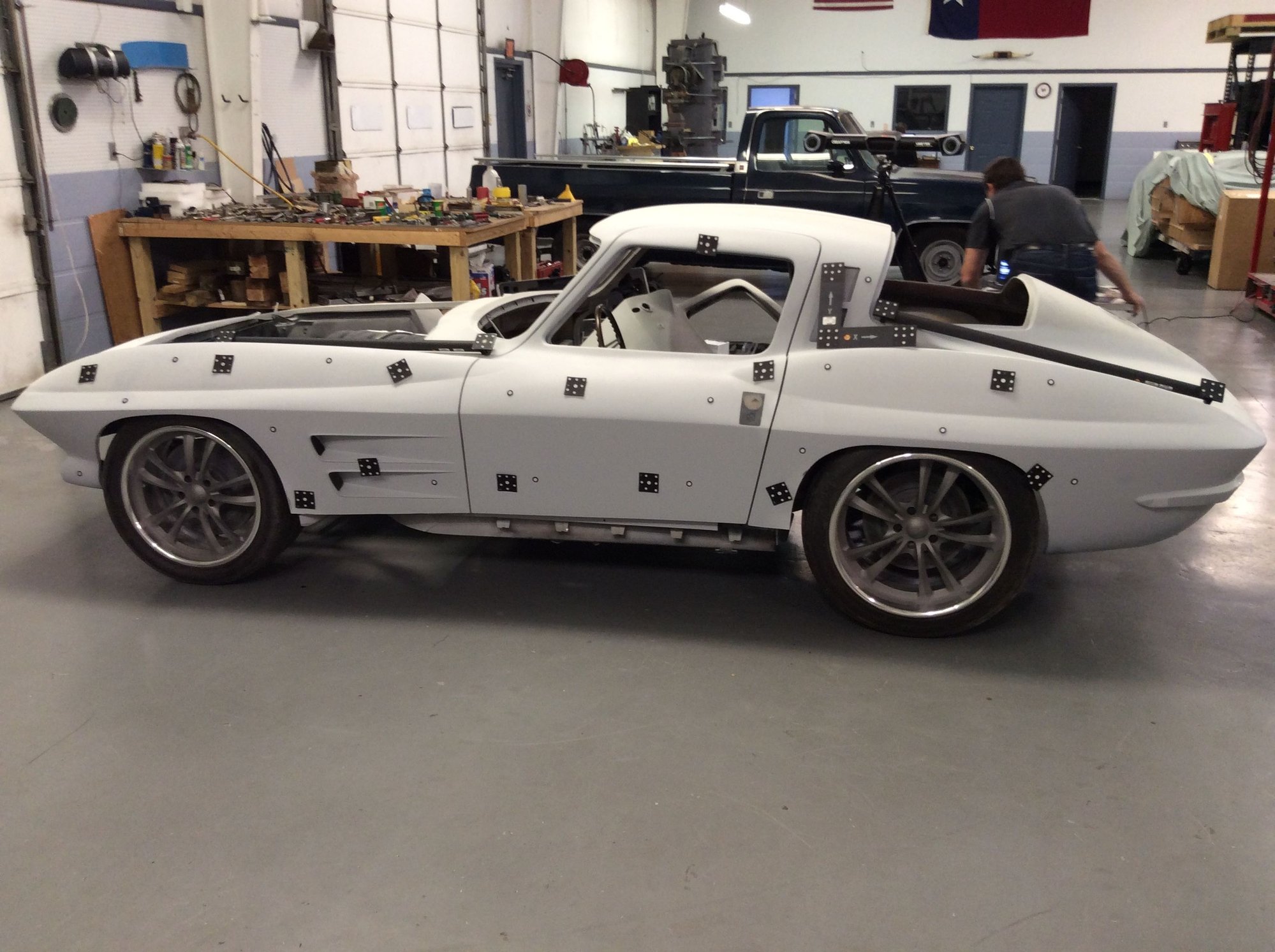

Corvettes have always used Positive off set wheels (Wheel's center face is outboard of center-line of rims width, less rim showing. Negative offset, more rim showing, wheels face is inboard of rims center-line aka like below, one car has 2 1/2 in flared fenders, the other stock.)
About all wheel manufactures can do to try an show more rim is to try and concave bottom of spoke design inboard to show a little more exposed rim, like that of car in the 2nd picture.
THe car below had to be Flared 2 1/2" with Aftermarket chassis with C4 suspension to do show that much rim on front and rear to do that, Car below it also has 2 1/2" inch flared fenders, same chassis, but C6 suspension so there is less exposed rim on it. Body's outboard, an it's suspension and/or frame inboard limiting factors. It is what it is.
