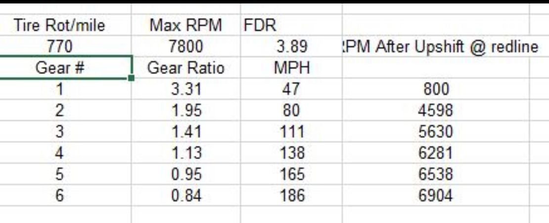

Default top speed in first 6 gears
This is what i have come up with and it seems to match at least some of the speeds others are talking about

GT4 has a rep for tall gears, but look how close together they are after you get to 2nd:
Just perfect for the track.
