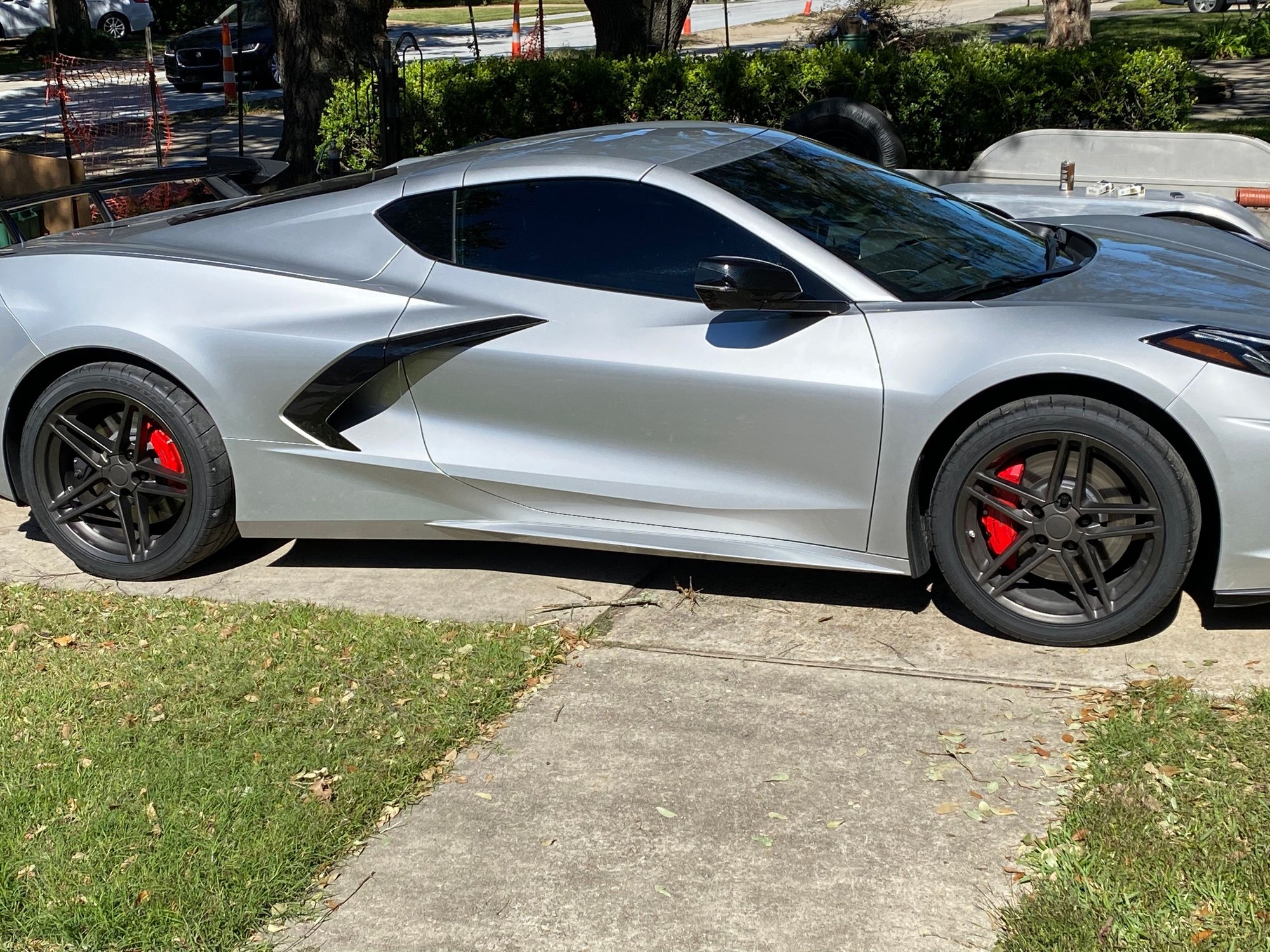

Not quite sure what y’all are talking about, I have been using C6z wheels as track wheels, no problems. C7z wheels (front) have a 43mm offset. The sweet spot is 40mm. The rears from the C6z or c7z are both fine. But suit yourselves.
