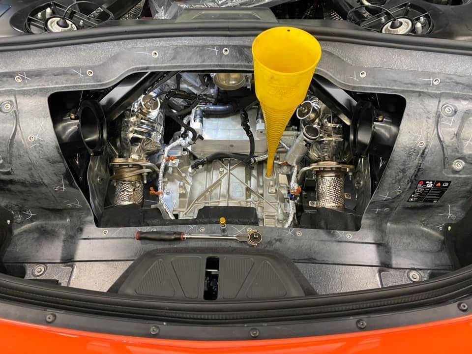

From my dealer today. Not my car, though mine is behind it in line for the service.
Looks like you remove the panel to get to the air filter, then remove the air filter housing. Not the end of the world.
From the service bulletin on this procedure, there were a few bolts that if you removed, would bork the whole trans. Thankfully none of them appear readily visible and lurking there
My dealer will also be flushing out the OE brake fluid with a track-worthy equivalent, will share if anything unusual comes of the process.

Nice... I saw Alan post those today on FB. Those other bolts you see are the shift shaft supports and will FUBAR the trans. The fill plug is a different color and has a femal hex insert vs. a bolt head; you can see it sitting on the tub there facing up. Let us know how the brake flush goes. What fluid are you going with?

Sorry to ask, but why is this process necessary?

This process is the transmission top off for track use.
I would assume that it has to do with better high g lubrication and cooling.
