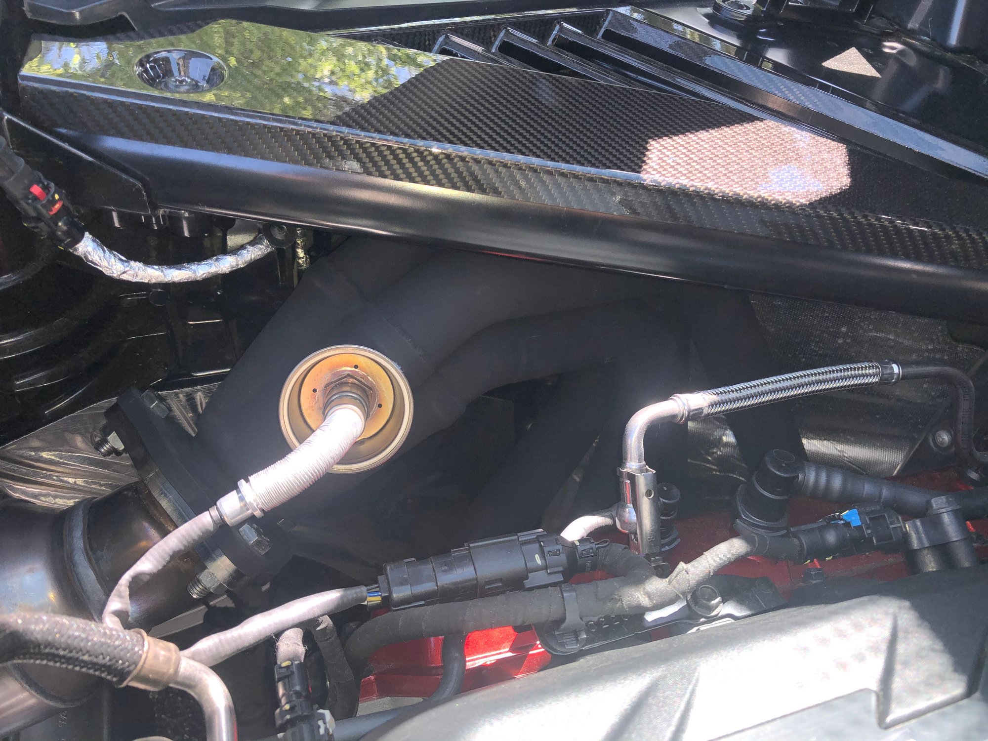

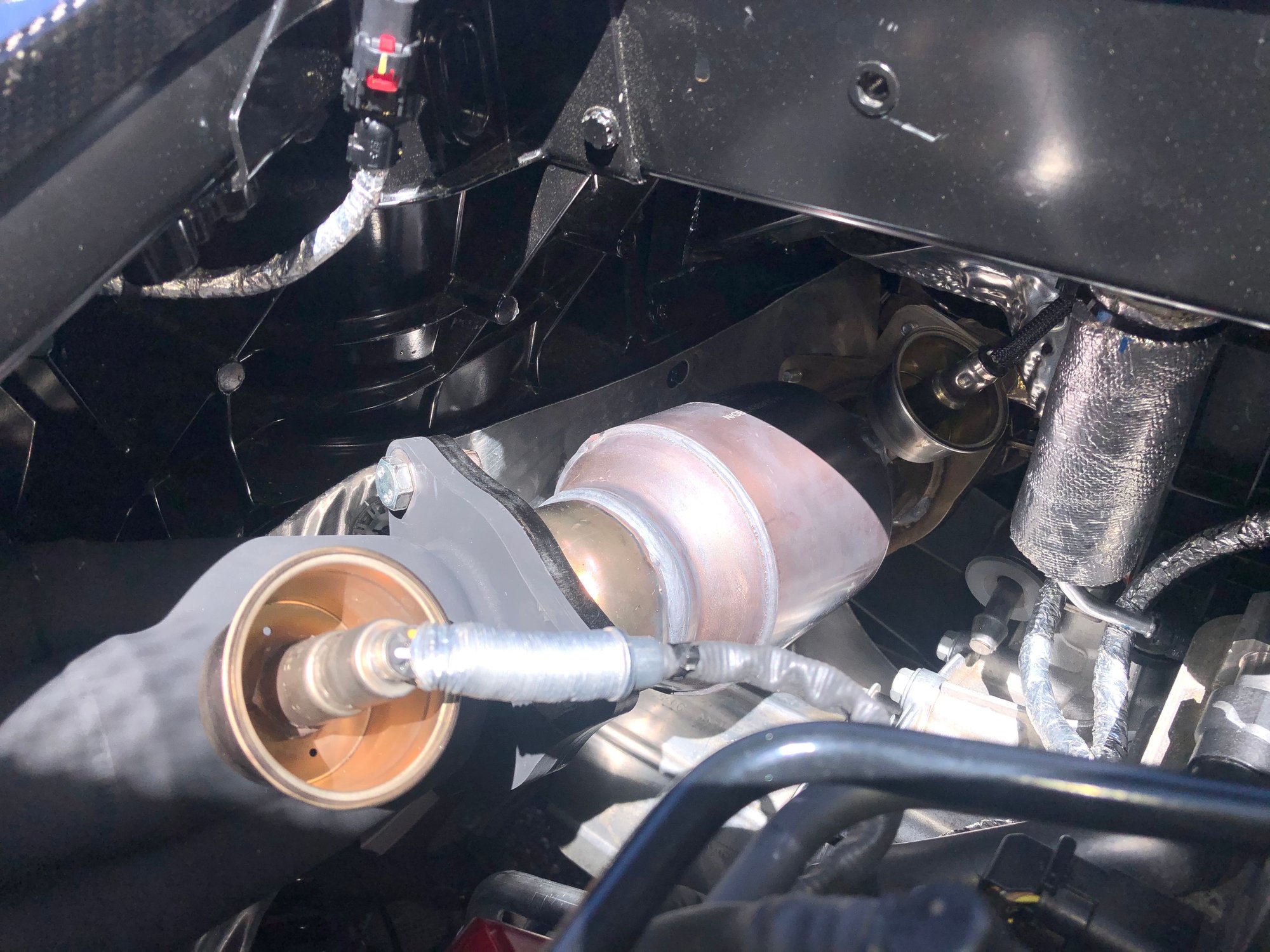

Headers and high flowcats installed with NPP exhaust and had a question. Like the C7s, is there a fuse or fuses that you can pull to keep the baffles open at all times?
I have been driving around and no check engine light so far . Sound in my opinion is amazing. Power increase without a tune is good. We gained almost exactly 21 rwhp but the good thing is, there were gains across the entire band.
There will be a full write up but so far this seems to be a good way for some decent gains without requiring a tune.

how is it running under there with all the heat sheilding gone ?

temps are good. Plus the cats are about half the size of stock. Write up to follow.

Pretty Cool, headers out already, or did you make them?

Did you ever say whether or not the headers are custom made or from another supplier?

definitely a supplier. Kooks Headers

1. Is Kooks close to you? Is this going to be their production kit?
2. No heat shielding on the cat?
3. I'd love some chrome Jet hot coated LTs under the glass.
4. What are the AFRs like on the OEM tune?
FYI the front sensor is a wideband now.

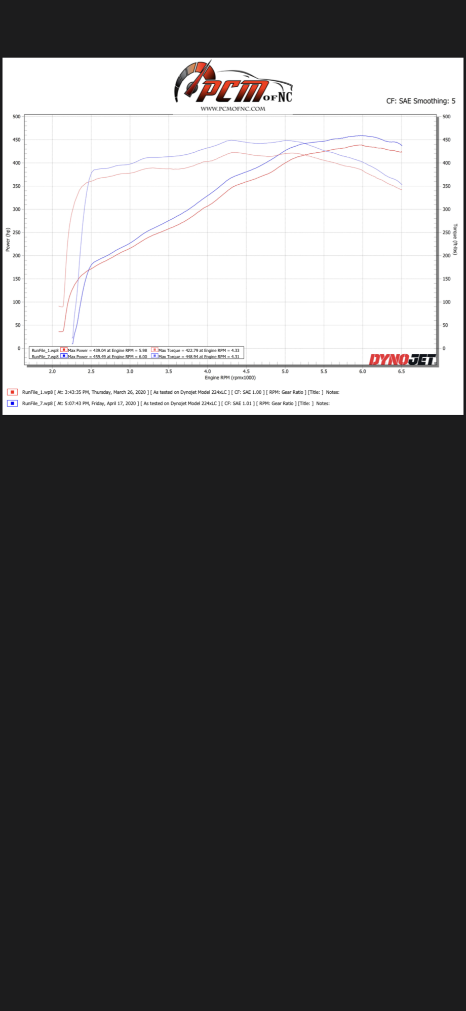

OP: Can you post the dyno graph?
Sure, here is stock ( mine dynoed very low) vs. the install (blue). It was still climbing also until the end run so I do think there is more there once we run the car more.
Nice gains. Awesome that it has a wide band sensor, be great to see how lean/rich it kept it.
