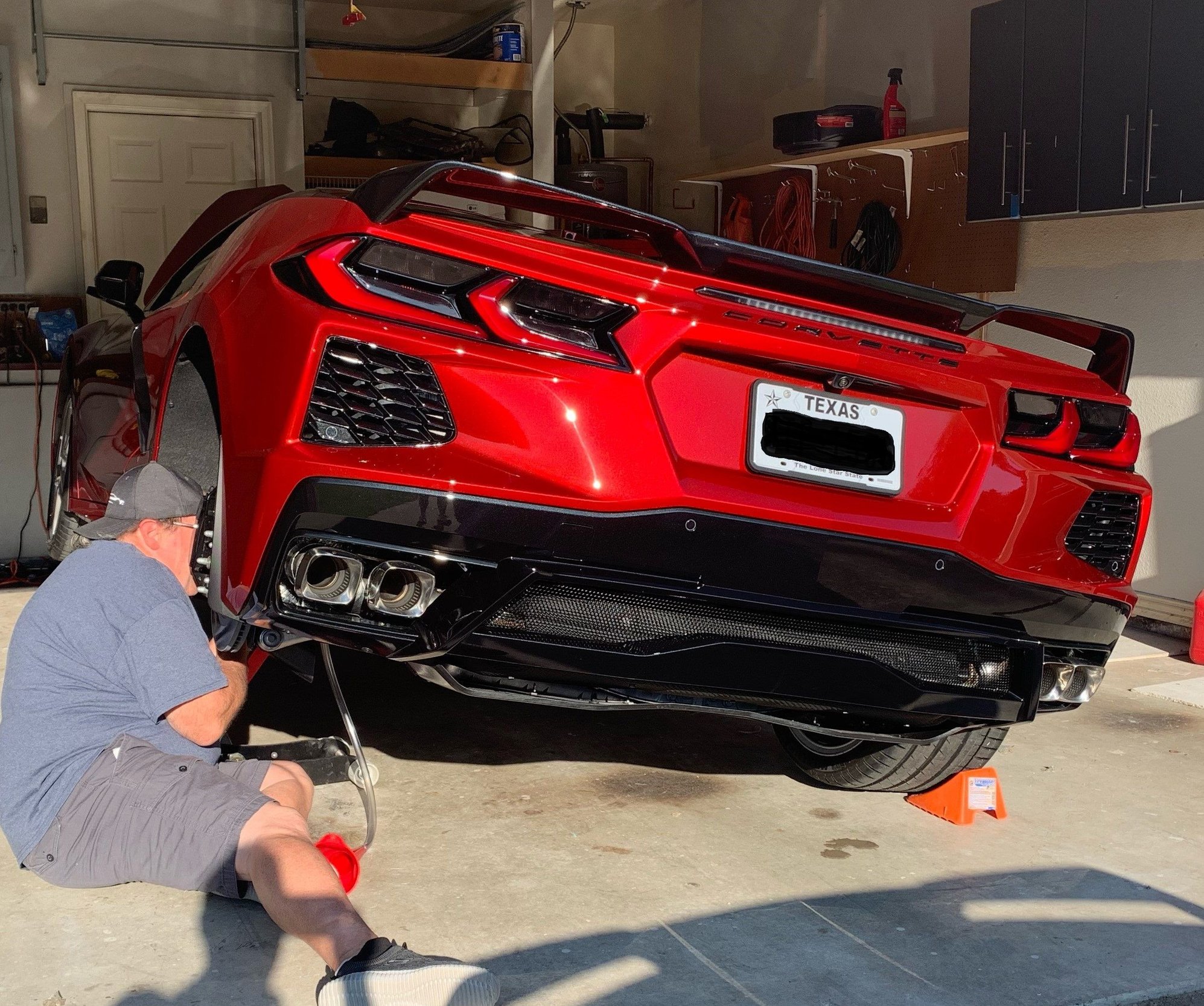

They did not short the transmission fill. All C8 DCT are filled to factory spec. If you have z51 and are tracking the car you have to overfill the DCT to keep warranty.
Bolt below axle is the OEM fill level check for DCT.
