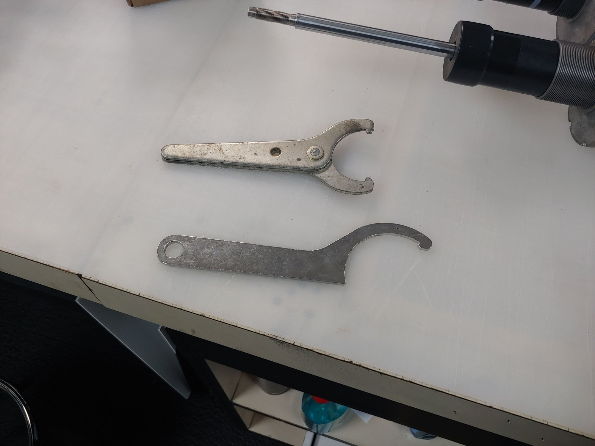

shock on the right is at factory setting, the left shock is 1+" lowered
the rear shock closest to you in the pic is at lowered setting, 1+" easy to get.
when doing the adjustments, use the proper tools.
