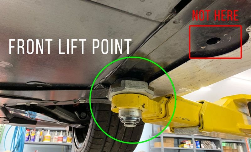

MAKE SURE YOU KNOW HOW TO LIFT THE VEHICLE!
Before starting please be aware of how to safely lift the vehicle. The C8 has both holes AND slots on the underside and you CANNOT use the holes as lift points. Please refer to the images below to correctly identify the lift points. Failure to do this correctly is both dangerous and expensive.
We cannot advise strongly enough to use caution in lifting the vehicle.

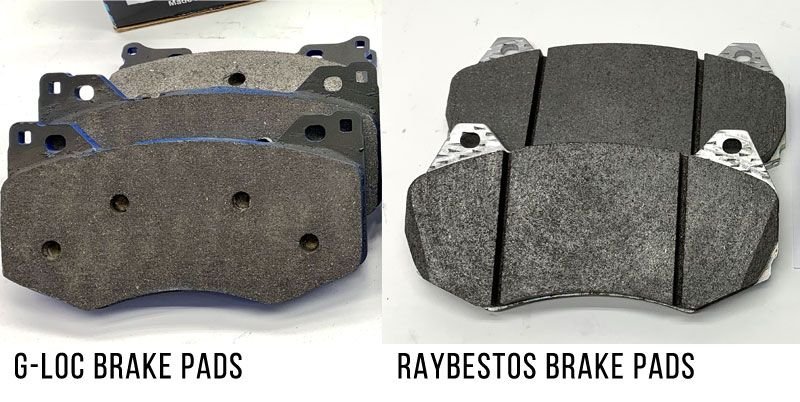

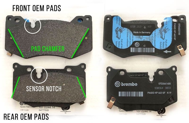

Note the race pads where we have filled the chamfer's and sensor notch with added pad material. We also have low dust pads available to those who prefer that.

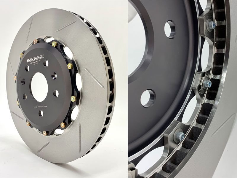

We installed two-piece Girodisc brake rotors on the Kaizen Motorsports C8 Z51 Corvette. In addition to increased durability, these rotors offer significant un-sprung weight savings.

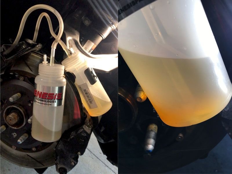

Brake Bleeding
You will need approximately 3 half liter bottles of brake fluid to flush the whole system. Disconnect the battery first and keep the hood open.
The magnetic bottles are very useful in collecting old fluid.
The front calipers have two bleeder valves each. Fit a small hose over the valves, place the other end of the tube inside a container/bleeder bottle. Use a box end wrench to loosen the bleeder screws until you see the fluid flowing. In our case the racing fluid was darker and more dense than the factory fill so it was easy to see when we were done as the new fluid settled in the bleed bottles. We used gravity and the brake pedal to flush and finished with the 'two-person' method to make sure there was no air in the system.
Keep adding the fresh fluid to the brake reservoir as you bleed. Note the 'chamber' on the top of the master cylinder reservoir will limit how fast you can top it off.

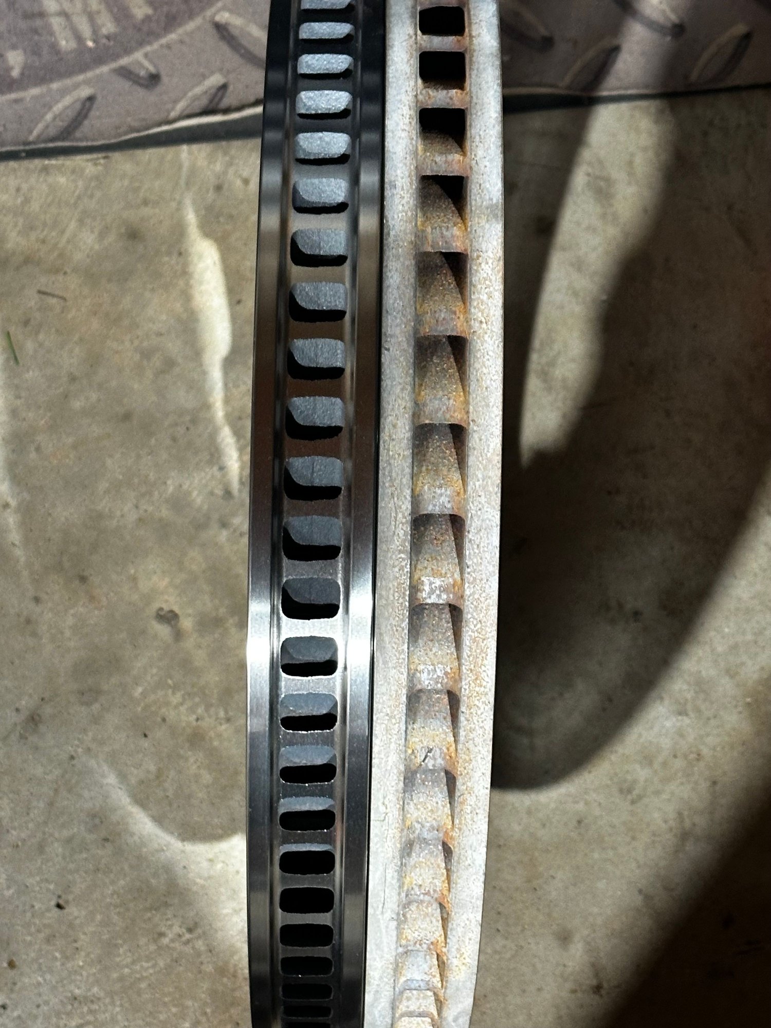

Originally Posted by Jdsaoijc%!
Does anyone know the screw size or description for the front rotors? I need to buy two new ones.
Honestly I’d leave it off. In time it will freeze up on you. Put rotor on and hold it in place with one lug. Put caliper on which will hold the rotor in place. Remove lug. Put wheel on and done. They are pretty common to get.
While I’m at it here’s a reference to my new Girodisc vanes compared to my Brembo type 3 rotor.
