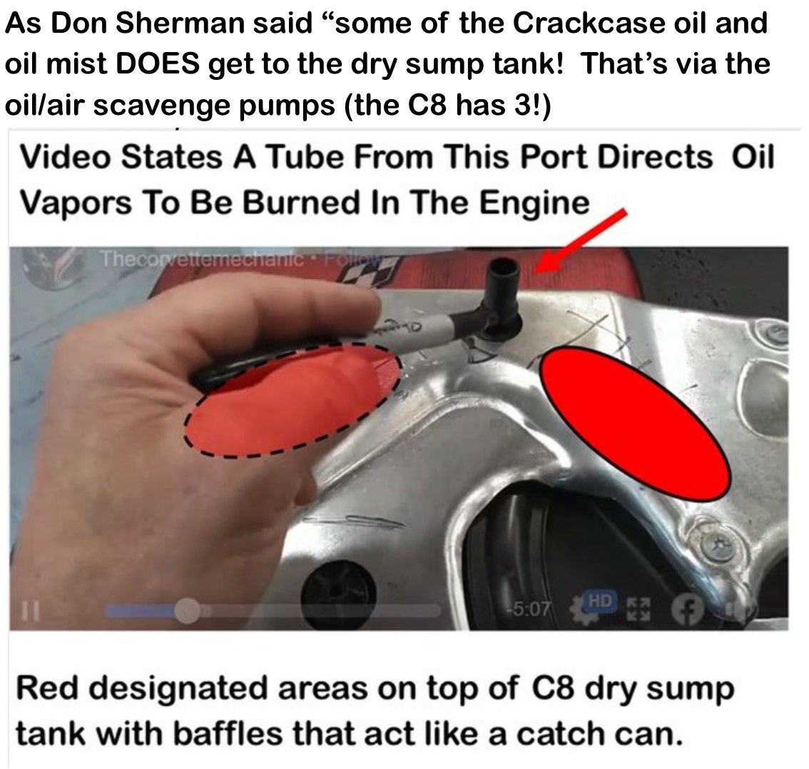

If it was mine I would start up and check the level. The LT2 has 3 scavenging pumps so excess oil in the block won't be an issue. I think you'd have to overfill it to the point the reservoir is completely full for there to be an issue just to check the level. You might pull some oil into the intake, but a one time incident isn't going to hurt it in the long run and I kind of doubt you will with just idling it.

Have not seen posts with significant over. Don't see long term but more short term issues like blocking oil from the PCV system being returned to the dry dump tank.

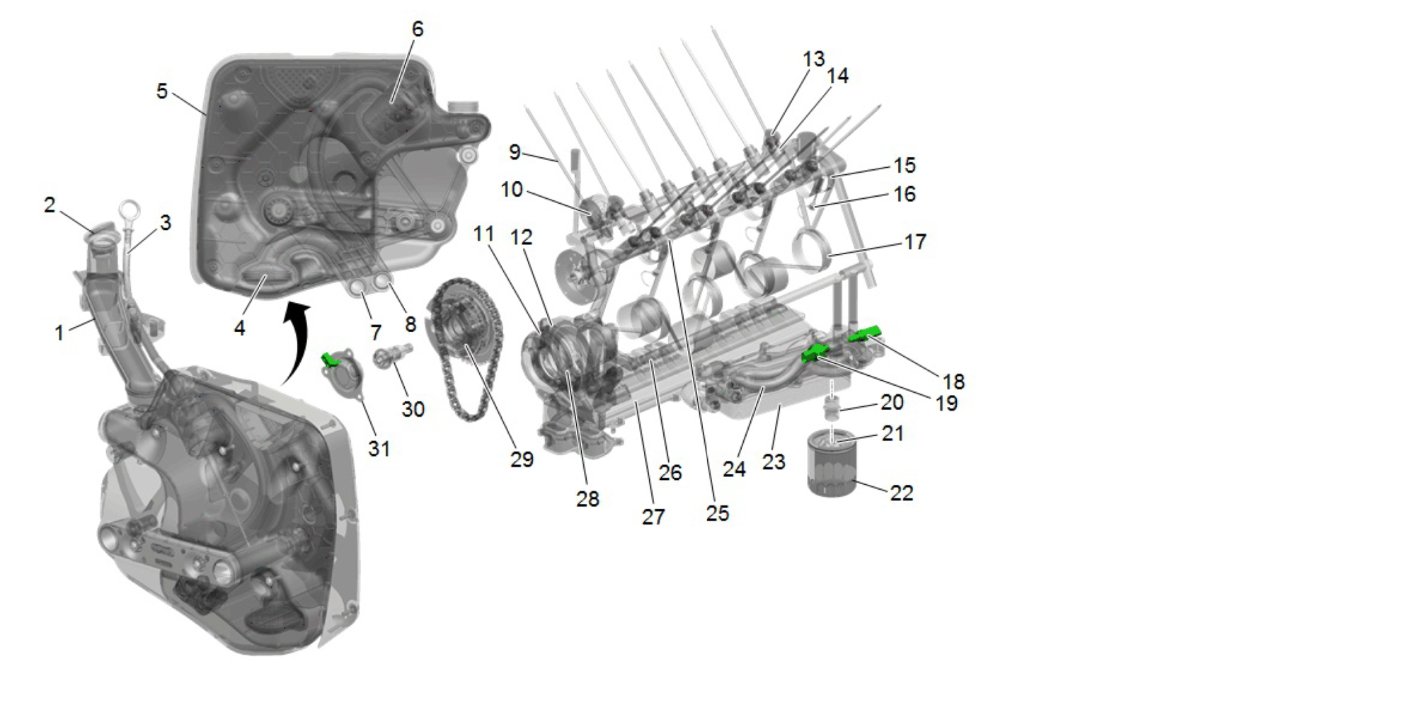

Right! The service manual says the oil tank has a "centrigfugal airoil spearater".
"Incorporated within the engine oil tank assembly are the oil level indicator(3), oil fill cap(2), positive crankcase ventilation(PCV) centrifugal air/oil separator(6), and an oil pick up screen(4)."
If the tank is overfilled it will interfere with the operation of the PCV system. One can speculate that it might affect crankcase pressure, but also it will prevent proper venting of the oil tank as oil and vapors move into and out of the tank during operation.
