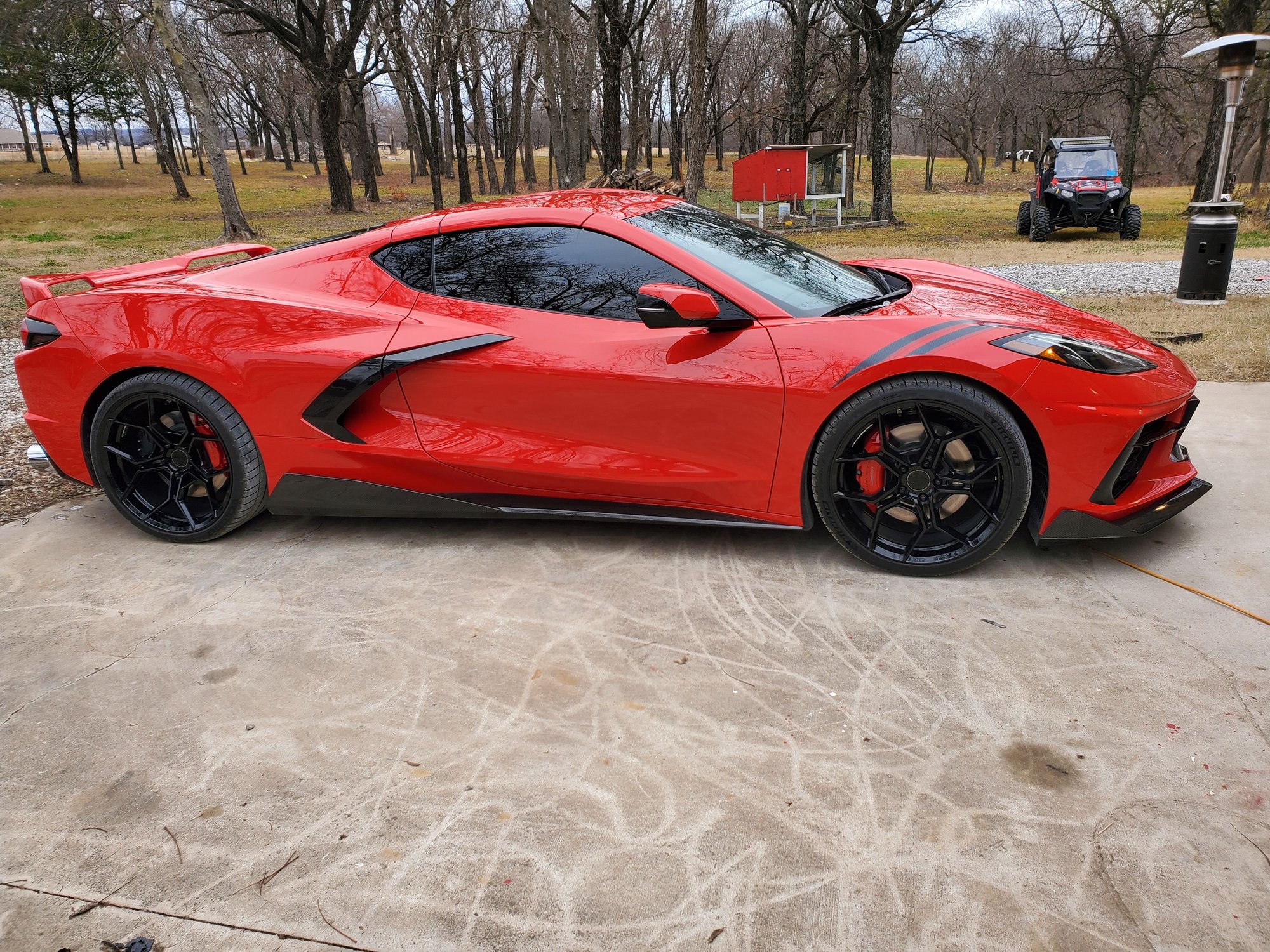

i run 265/30/20 ps4 on front and 325/25/20 ps4 on rear right now. with the car lowered the front does rub a little a hard turns while braking. I also have race camber set as well which contributes to this.

Old Dec 16, 2020 | 03:10 PM
marksstingray's Avatar
marksstingray
Joined: Jul 2016
Posts: 92
Likes: 19
Old Dec 16, 2020 | 05:10 PM

Originally Posted by marksstingray
Wow! That Gloss Black setup looks perfect on your Torch Red! 💗🖤
