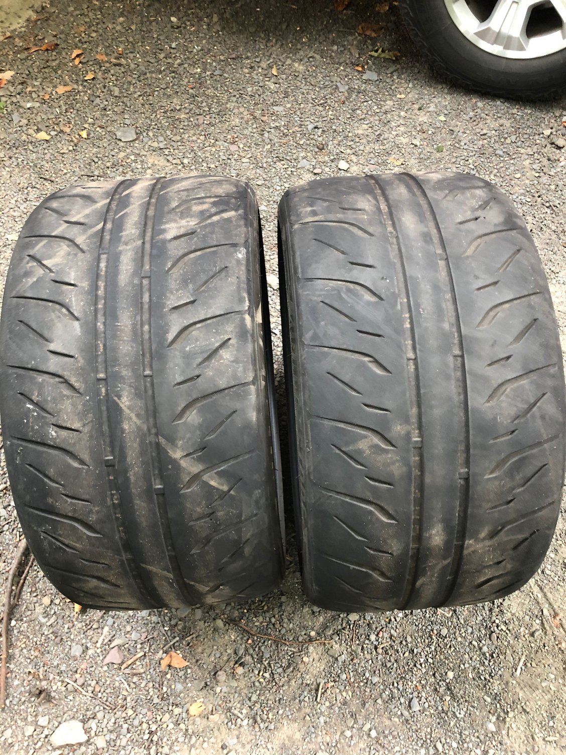

0.9 will work fine . Personally I like the tire as soft as possible so it rolls over on its edge . More contact path but of course there’s a limit before you feel like your on ice. With the R71R’s I started at 32 front 30 rear and slowly worked my way down to 28 front 26 rear because that’s exactly where all 4 tires roll over to where I want them for most contact patch grip. Remember depending on what alignment anyone runs determines what pressure they need . Factory alignment with far less negative camber that I have would require more air so you would destroy outside tire edge and sidewall before the rest of the tire . I get even tire wear tracking/ autocross/ track sprint with max negative camber and correct pressure. Tires rolling over in turns.
These are 295/30/20 R71R’s- to skinny for me on a 11 wide wheel but look at tire wear , it’s perfect and this is with 2.6 degrees negative camber and 1/4 toe in and driving them to and from events 2 hours away.the fronts were so nice my son stole them and put them on his camaro.
