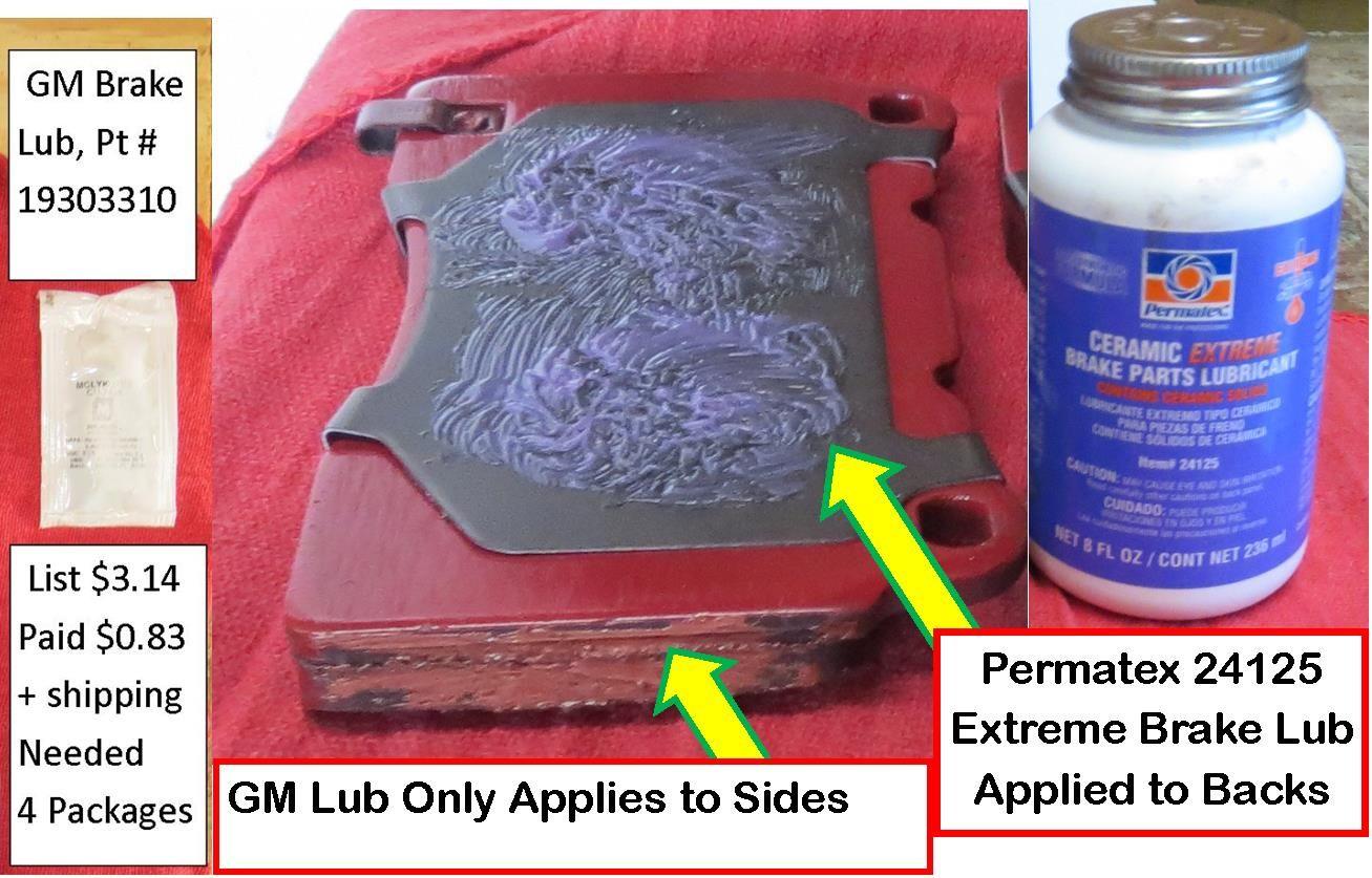

See posts 15, 17, and 19. Dealer may put on "Brake Pad Grease" (I use ceramic pad grease, no longer the GM copper colored grease.) I put it not only on the metal pad sides (where GM recommends) but also on the back of my replacement low dust pads. Never had an issue with my 2014 Z51 after switching pads, my 2017 Grand Sport or C8 Z51 which I also installed low dust pads as soon as I got the cars home!
GM will reimburse dealer to pull the pads and install grease. Probably will go away but may come back. BUT the problem isn't lack of grease! That will mask for a while the vibration caused by inconsistent pad material deposited on the rotor (call bedding.). It's very thin so you can't see it but after 6 months I switched from OEM pads on my 2014 C7 and that is best done by removing the residual pad material from the rotors.

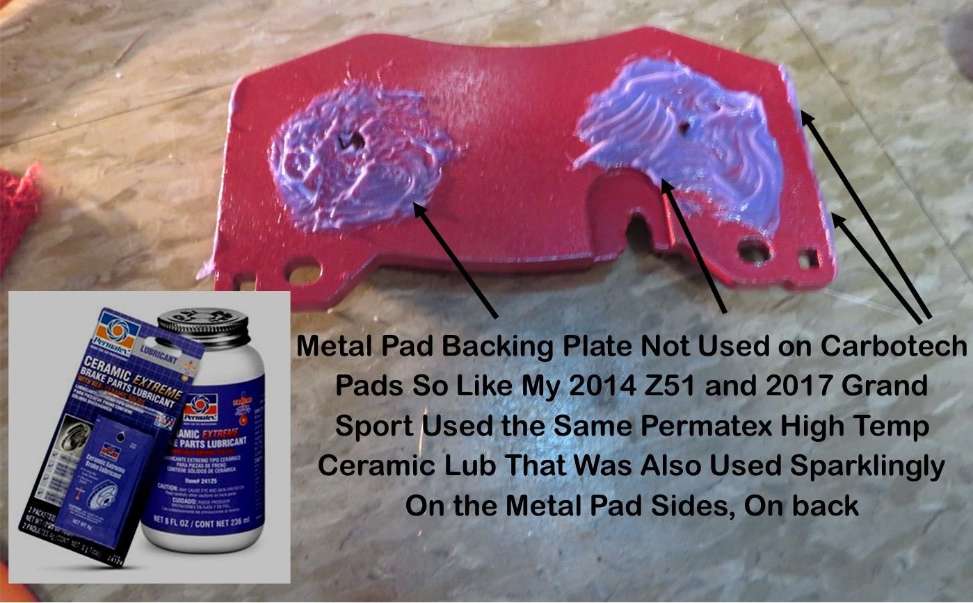

If I just had a squeak I'd pull the pads, lub the sides and back of pads where they contact the pistons and check for proper top spring install.
Here are some pics or what I used when installing Carbotech pads on my C8 (and all other Vettes) : Use on OEM pads with or without baking,

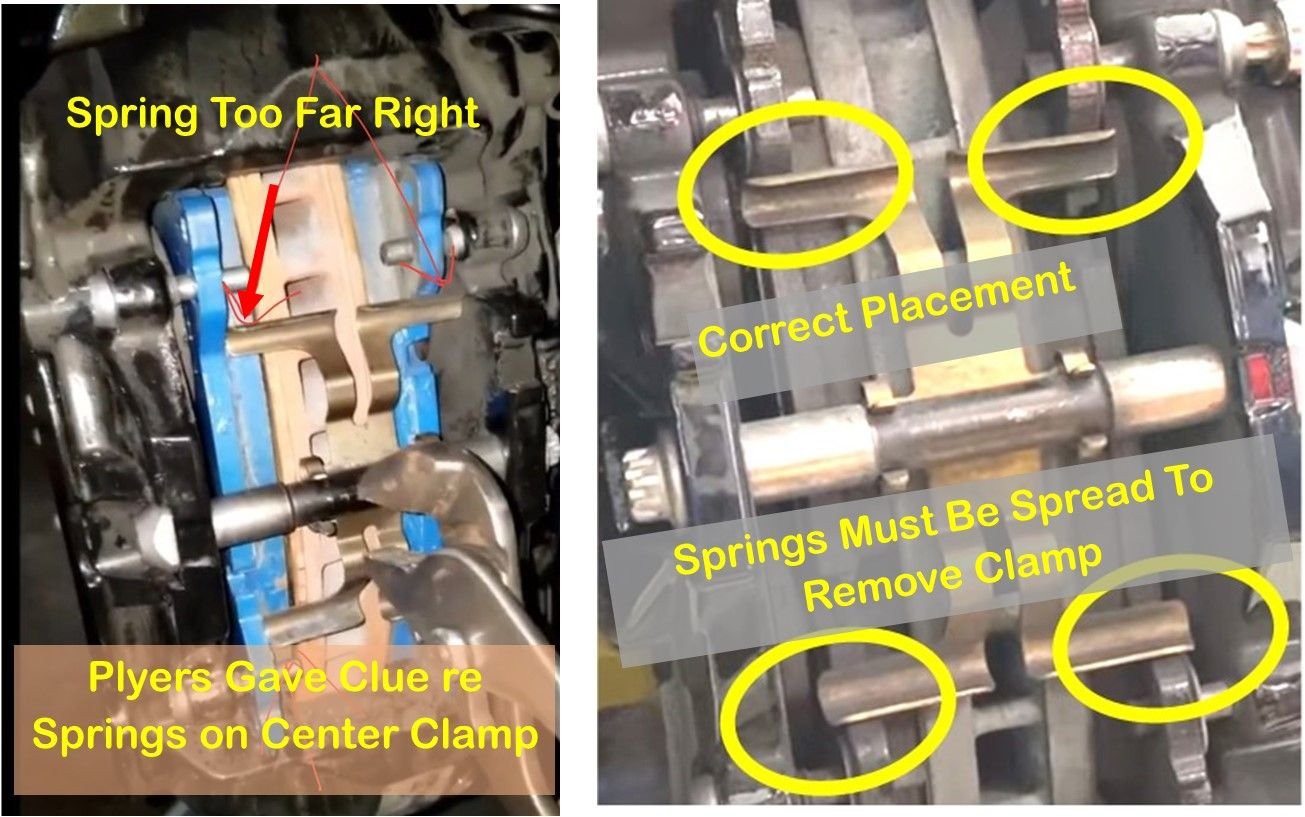

Member showed where the top spring was not properly placed.

I switched to Carbotech 1521 low dust pads after 6 months. Foolish to wait that long.
On my 2017 Grand Sport and C8 Z51 switched pads week one. Never a squeal BUT I apply the brakes aggressively frequently. It's fun, try it! Need to do that to maintain that thin uniform pad material layer.
