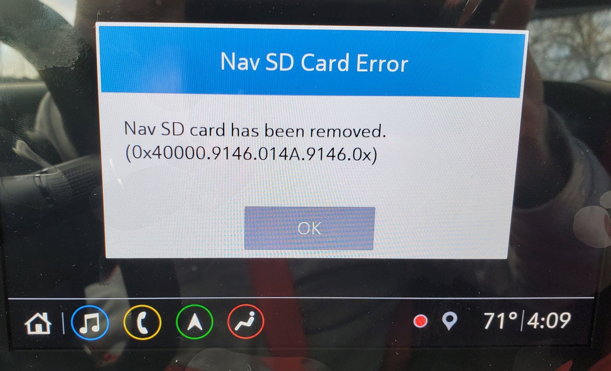

@zo6devilcar Glad you posted this--great research! And it happened to me today; and only then did I find and read your post.
Here's how my experience went down this week. Got the car in December and had not driven it much while waiting for my PPF install. While my detailer had the car, I ripped several CDs into 320 kbps FLAC files on a USB drive using MS Windows 10.
When I picked my car up Tuesday and inserted the USB thumb drive, the infotainment system repeatedly indicated no drive inserted. After several failed attempts, I just let it be. Then a couple of car re-starts later in the day it then recognized the thumb drive and worked fine. Oddly, on the same day, my Nav wanted me to again accept all the new user agreements, as if it were the day I took new delivery. I thought it was due to the car having been on the battery tender for a couple of weeks.
Today, while listening to my new USB tracts, I selected the NAV app and got the error message below. Pulled into a parking lot and searched and found this thread. After inserting and reinserting the Nav SD and thumbdrive, I was unable to get the Nav app to work. Then the USB could not be located. Tried removing the Nav SD card again but couldn't get it to pop out of the slot. Also, I stopped and restarted the car with no effect. I then unplugged the USB and drove on.
About 15 miles later I parked the car. Returned in about 20 minutes and the NAV opened and worked.
I have not had the opportunity to try, but I wonder if just switching to a non-USB audio source before activating the Nav app, then returning to the USB audio will allow both to run concurrently. Anyone tried this?
Also, if you have re-ripped your tracks at 160kbps, have you noticed a discernable loss of audio quality through your C8 audio system? Just looking for work arounds to having to re-rip my CDs and possibly sacrificing audio quality.
Nav App Conflict with 320kbps USB audio
