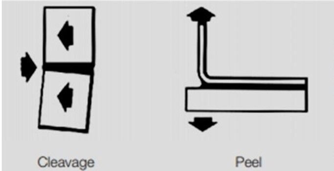

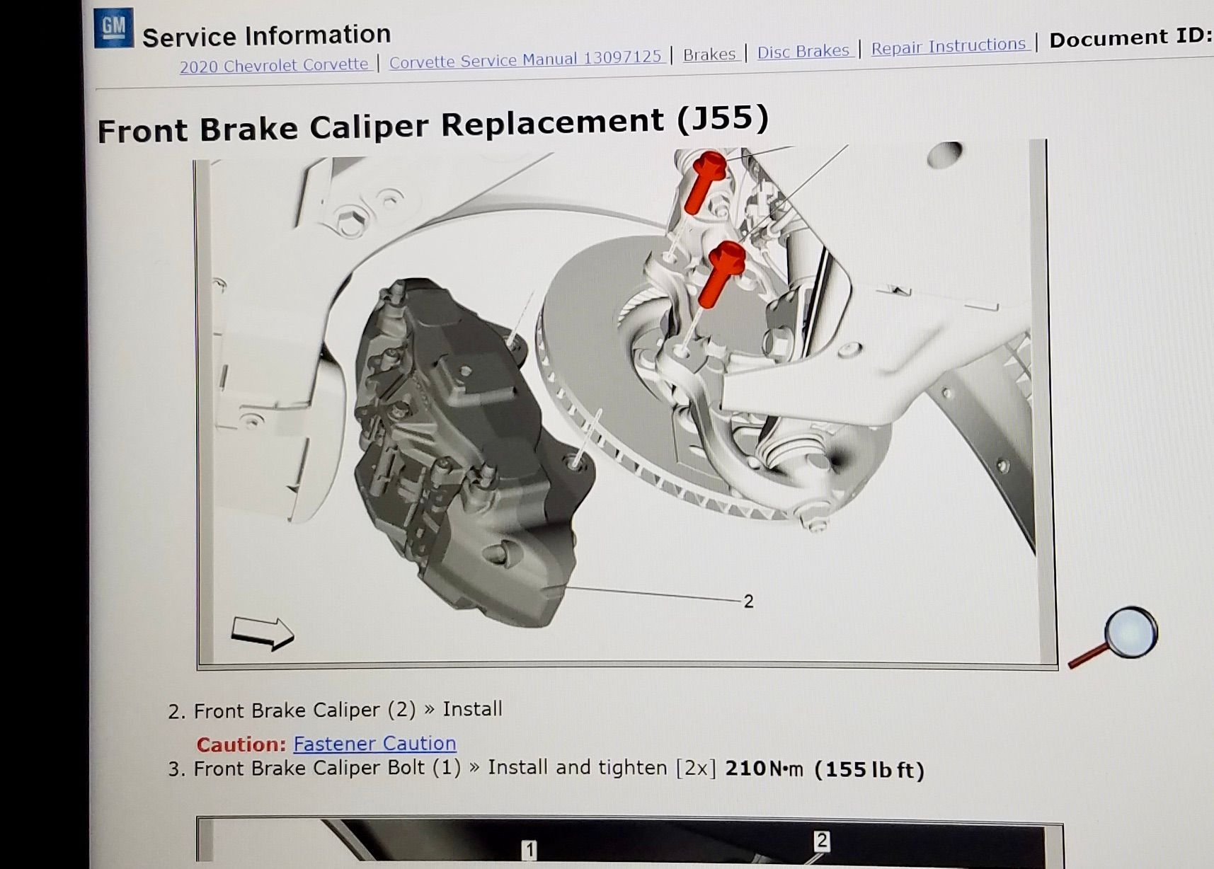

Hi, sounds like you 1st removed the caliper THEN used a screwdriver. Since you changed rotors you obviously had to remove the calipers, which as you note makes it much easy to break the holding force of the pad to piston double sided tape.
ASSUME since you had the car on a lift you could use a long wrench to remove the two caliper bolts? If installing as I did with just jacking there is no room for a long wrench.
I was hoping someone would try using a screw driver as shown below WITHOUT removing the caliper. As noted in pic below the adhesive will release a lot easier in what is called "Cleavage or Peel." It stronger is tension. With caliper in place there is little room to create "Cleavage." As you note IF you use what I did on my early 2014 Z51 front pads AND my C8 front pads, a paint scraper and hammer, have to be very careful to NOT nick the piston dust boots.
Still looking for input on IF, with the Calipers in place, this "IDEA" can work to release the strong brake pad tape hold on pistons to pad (front pads only just like the early 2014 Z51's.)

First I would like to thank you for all the PDF files you have on your site, I've been using them since I got my 2014 C7
I don't think you have enough room to twist the screw driver to get the pads off without removing the caliper the 1st time with the glue on them. The puck seals are too big to get any tool far down to pry the pads away, you may be able to get a paint scrapper in there once you loosen the top of pad with a screw driver but I wouldn't take that chance for fear of damaging the seals.
Yes i did take the caliper off, then I followed your directions and used a screw driver to twisted from the top, they came off a lot easier than I expected.
I used my Craftsman 19volt battery operated impact lug nut tool to remove those 21mm caliper bolts with impact socket. For the install I had to jack the car higher to get my 1/2in torque wrench in there to tighten them to 155 ft lbs , I do use a lift jack.

Thanks for comments about my PDFs. Also thanks for the pic of the lift jack! Had not heard that 155 ft-lb requirement but logical considering the caliper bolt size and the task of supporting the caliper.
As I note in my PDF, I did remove the pads with a sharpened paint scraper. NOT easy and does require a hammer. I used a narrower one than I have used for my early 2014 Z51 that used similar double sided piston to pad tape. I was successful doing that with my 2014 Z51 BUT frankly it's more difficult with the C8 to avoid nicking the piston dust boots.
The issue is with just jacking the car would have to jack high enough to get a long wrench, like my 1/2 inch breaker bar to remove them. To tighten my 150 ft-lb torque wrench would need a lot of room. Do have a long reach, high lift jack but supporting the car with a jack stand for safety would have meant removing the aero panels to locate a suitable frame location.

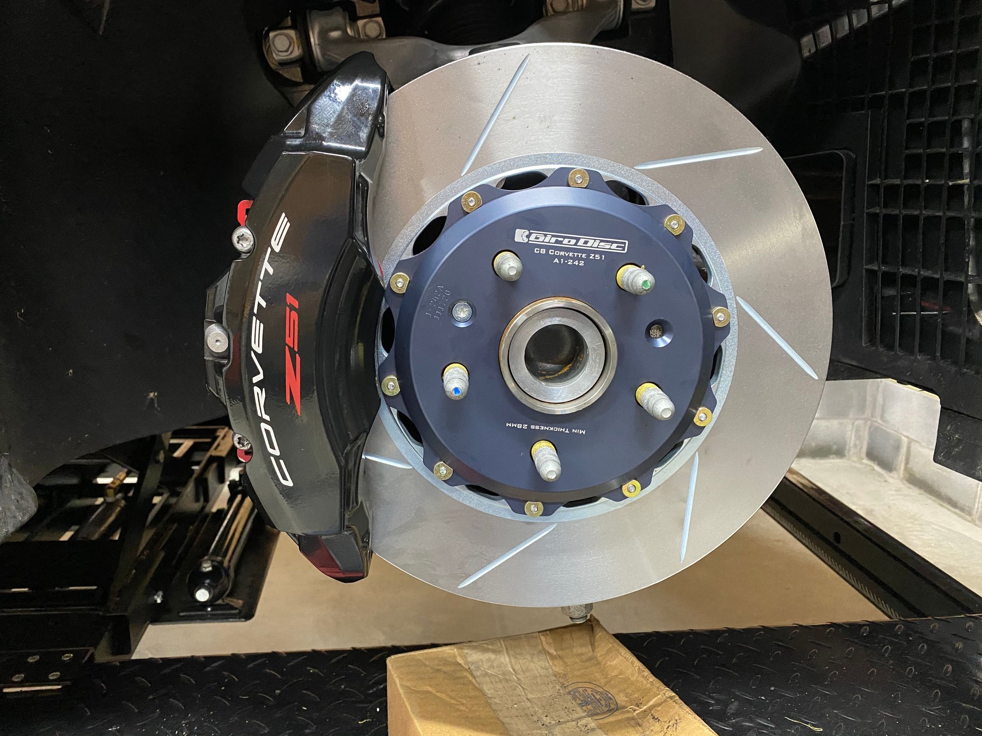

Carbotech 1521 pads with Giro Disc rotors , z51 C8
I did the procedure for transferring the pad material to the rotors , similar to bedding but not as aggressive .
I did 6 consecutive 60 to 20 slow downs and the drove till brakes cooled off about 15 minutes at 65 mph.
The instructions from the Giro disc rotors said it will be successful when I saw pad material on the rotors
this picture shows the pad material burnished onto rotor
this picture is before I did the transfer or mild bedding
