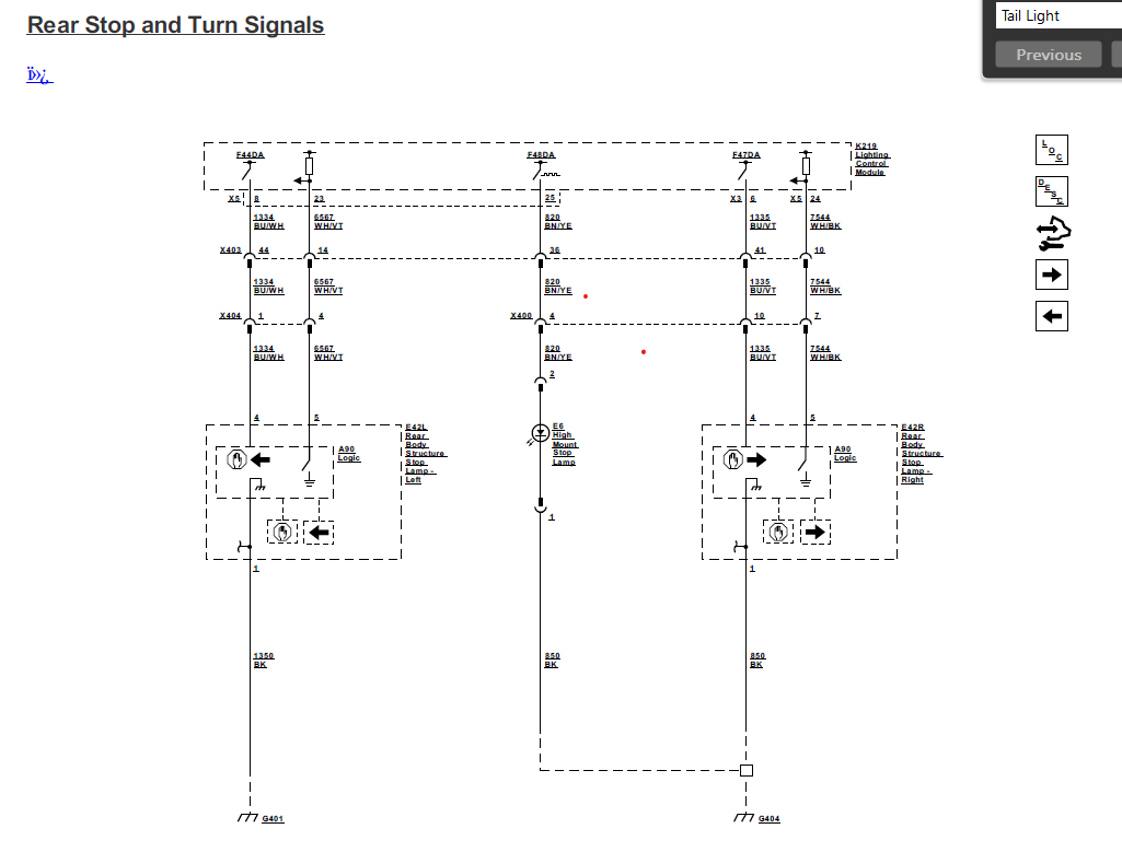

I have the rear facia off right now. Anyone know the wire colors for the parking lights? I assume I can tap it in one of the 2 big harness plugs that go to the taillights or directly at the plug going into the taillight
thanks

Do you have a voltmeter? Just turn the parking lights on and see which one is hot?
