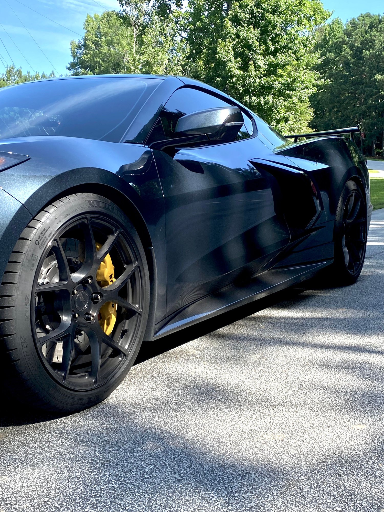

I guarantee you the the KW’s will give you whatever you want. It will put them on the the tires of you want. I usually don’t go to wild but I track my car so I have to leave some room for travel. Had to raise a couple times after they settled a few times as expected. Im only lowered maybe 1/2”. The KW’s are defiantly nice. Wide range of adjustability.

Is that the v3 kit? How’s the ride?

Yes the V3. I still have them setup how they came which is in the middle. Defiantly firmer over factory. Which for me is what I like and what it should be. But as with KW you can defiantly soften them up. Definitely has a more planted feel. Why more confident feeling. It allows the car to set quicker. Lot less roll. But I did add sway bars at the same time. I and some others will be testing very soon. My alignment helped a lot. Just 1.5 camber for now. Going in a couple weeks for a track alignment.
