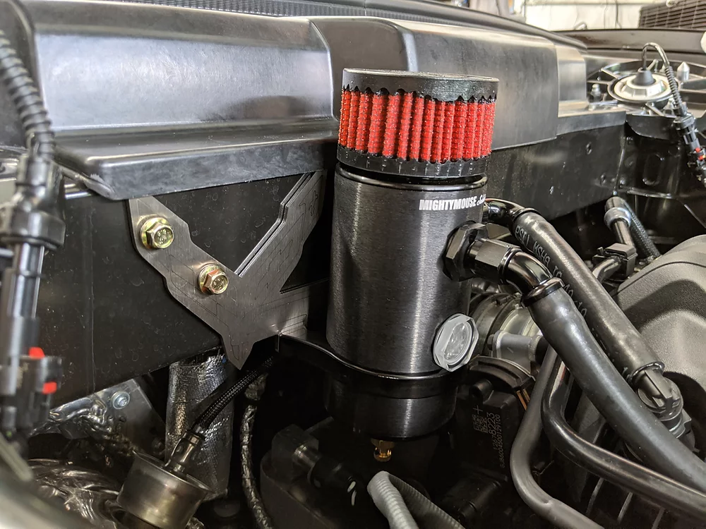

It was very easy to mount this catch can using two existing (but unused) threaded holes of a 2020 C8 Z51. Note that the MIGHTYMOUSE Solutions model catch can has a clear viewing port to check for any fluid contents but in ~6,200 miles I've not had to drain any fluid from it!! Those GM engineers have done a great job of controlling blowby on the dry sump small block LT2 engine.
Catch Can with a viewing port

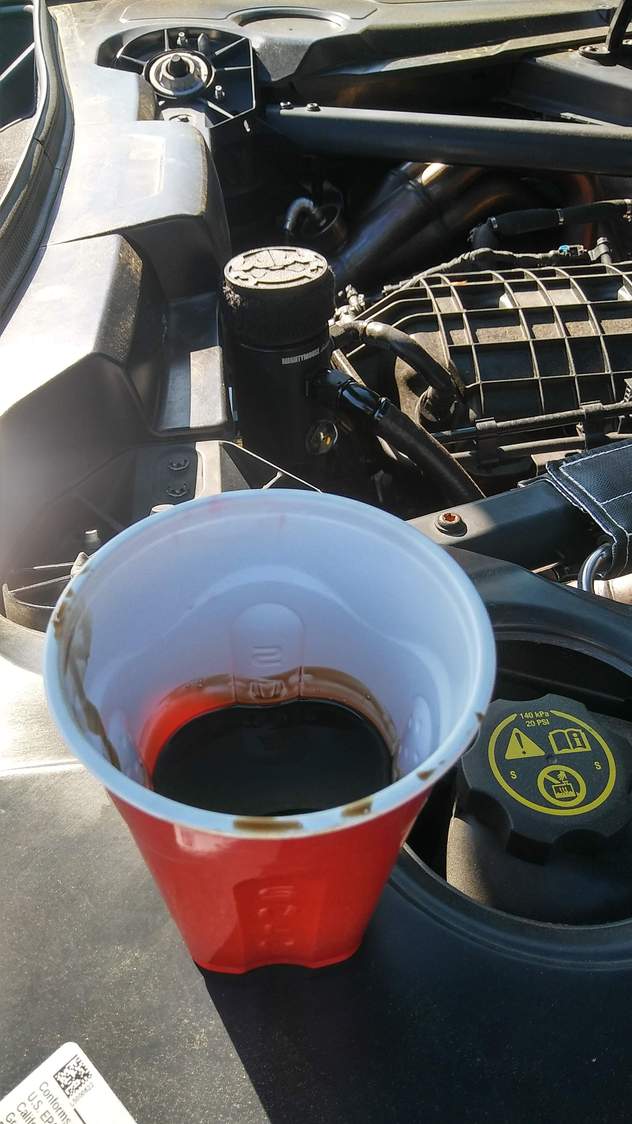

I love to see all these comments where people say the catch can will have no oil in it.
I see the mightymouse is doing poorly (catching nothing), but my JLT3.0 can catches a decent amount. There isn't an Oiler Elf that sneaks in during the night to fill up my catch can. Pretty sure it is coming from crank case vapors. I can't say for sure that this oil will be detrimental if it had been allowed to go through my intake, but I can say it is being reduced by about 1-2oz every 2k miles.

Looks like a LOT more than nothing to me!
We have many competitor units on hand and on average they test about 30% worse.
That's before we get into our unique pressure control, or the level window, upgrade path, yadda yadda.
