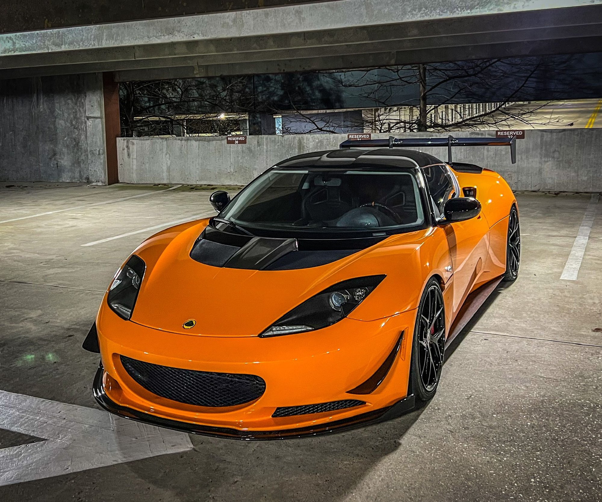

Yeah man a 14 Evora S highly modded, love it. If I could only combine the v8 with the handling of the Evora…
