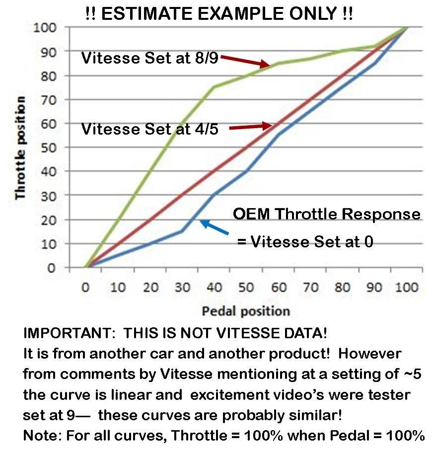

FWIW here is a graph of what the throttle controller actually does, which is nothing you can't do with your foot! BUT yep feels like you have more power because depending on how it's adjusted, pressing the throttle pedal 1/2 way could actually be more like full throttle!

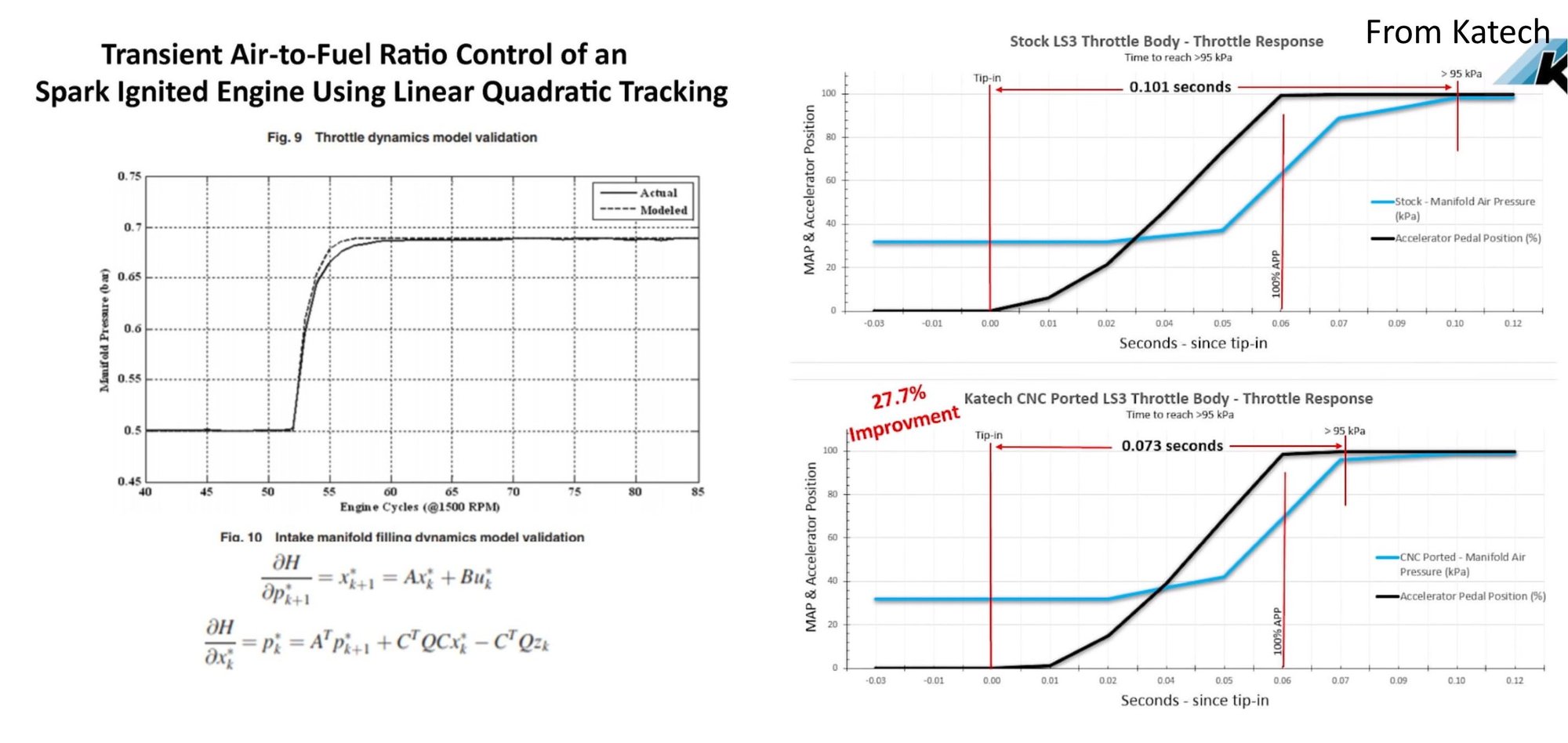

However the "ported throttle" is much different and does in fact decrease the inherent delay in response. Since my business involves transient flow response (in MIG welding,) I made a PDF for my C7 that may be of interest: http://netwelding.com/Soler_Mod_TB.pdf
This is not Soler but another throttle controller. They all do the same thing. In Touring GM sets Throttle control to a slow grandma initial acceleration with smaller gas pedal opening. BUT all have max set at MAX when your foot is to the floor! When set in Z Mode it's must faster, probably linier.

Ported Throttle Body Harder To Understand. But Basically When Throttle is Instantly Opened, it Takes A Short Time For Air To Flow at Max Speed. PDF Has A Lot Of Pics. This is One.
