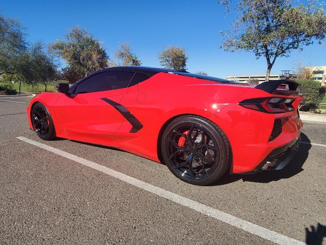

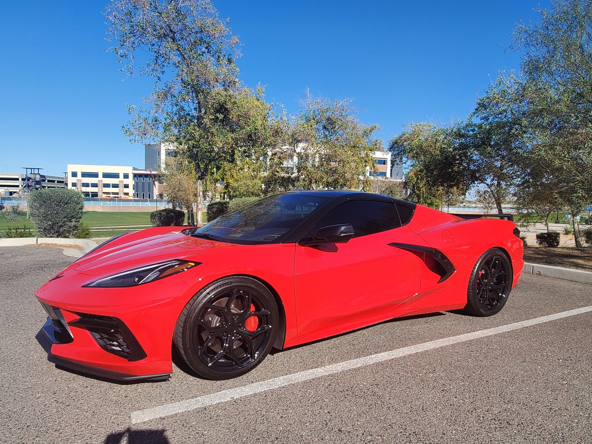

Yes, that is exactly what they do. The Z51 w/ front lift cant be lowered turning it down so you must use the collars as you have but they only get you down about .75" and I still had over 2 fingers of wheel gap up front, see pic below. A bit too much for me but I didnt want the slammed look or tucked tire look as pic attached from their site. I have after market wheels and they come out to the edge of the fender but stock wheels can looked tucked as you can see below.
The Paragon springs give an additional 1" of drop and to me 1.75" was a tad too much so they sell a $10 shim to use w/ their collars that adds back .25" I believe so it got me right at 1.5" and one finger gap all around. Plus the springs are 30% stiffer than stock so it tightens the ride up to about perfect! So final pic is finished height and I love it!
After collars installed but before Springs. Too high for me and this is a .75" drop w/ collars!
Didnt want the tucked look.
Paragon springs and collars up front w/ shims added back in. I love it.
