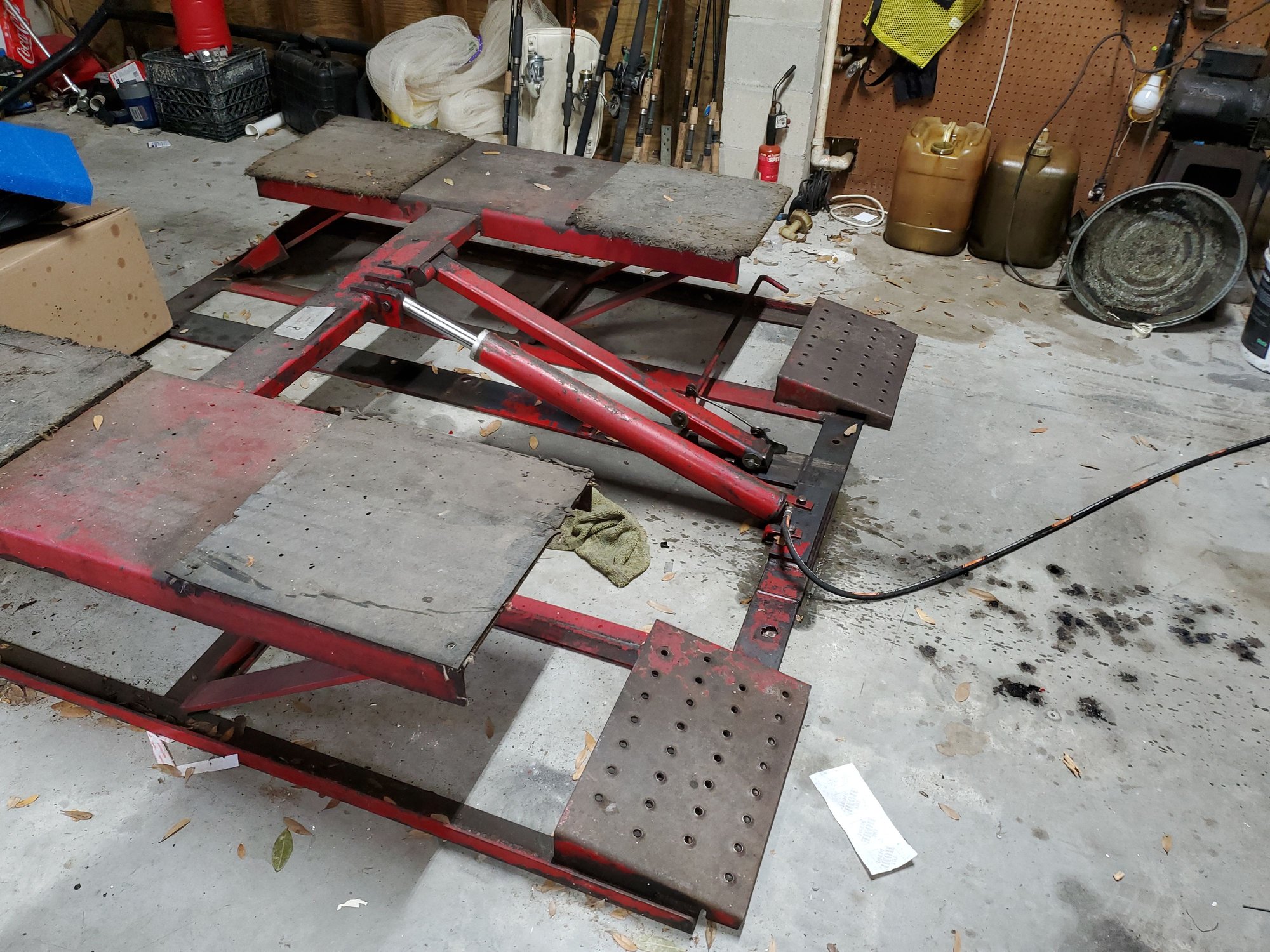

Have an old floor lift I've used on some of my classics over the years and wondering if I can utilize this lift on my 22. Might need some approach and exit ramps to get over without bottoming out but think that part is doable Concern is will the flat area where that goes up under the car hit anything and will the jacking areas end up over a flat area of the lift. Guessing i'll also need some pucs. Any info would be appreciated.

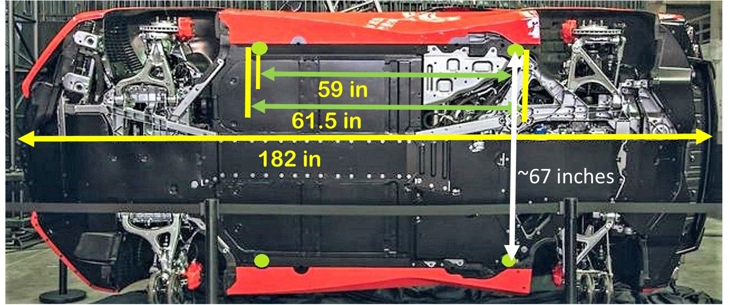

The lifting points are 66" front to back. You show no dimensions, not sure about your width.

Looks like 54" length and 71.5" width. Guess I'm sol and my old lift is only for my old cars.

I was thinking about one end at a time and that is better than nothing. Bummer it's to short. Gotta pull rear bumper for spoiler and get under the front for screens one end at a time. Least one end at a time I can have the tires be the load bearing point.

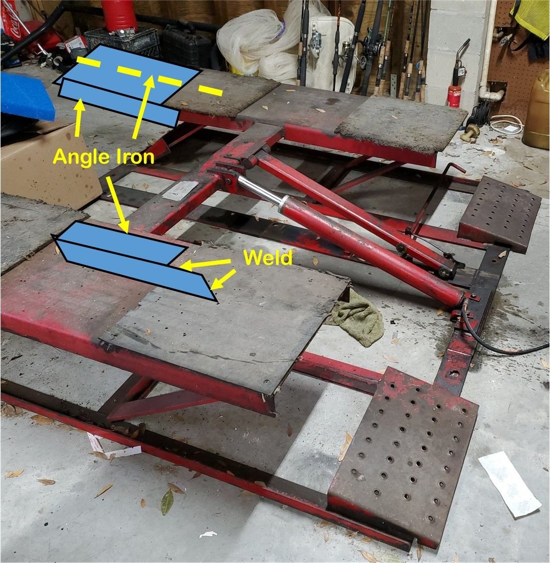

i would not give up so easy! Any good weld shop could add to the length by welding angle iron to the back with a steel plate over the top. To provide extra strength I'd weld a piece of angle to the new and old top plate. Extend the base angle iron or replace that rear base angle iron with a section of flat plate so the new angle fits..
I'd notch the side angle iron as shown to get a larger surface to weld for added strength

Great idea. I've been needing an excuse to pick up a welder. Was thinking about it today for other projects. Hmm.
