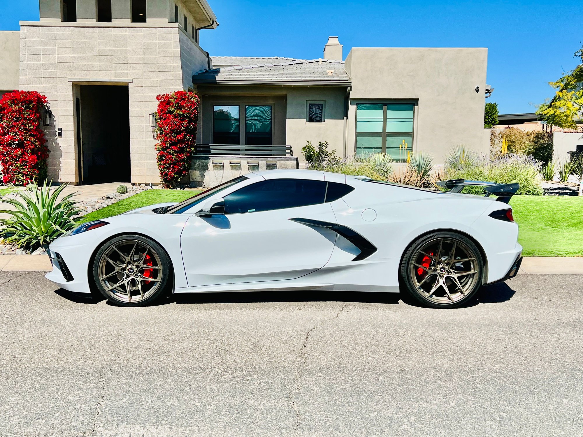

20/21’s, with KW Coilovers, dropped around 1.5”…no rub
