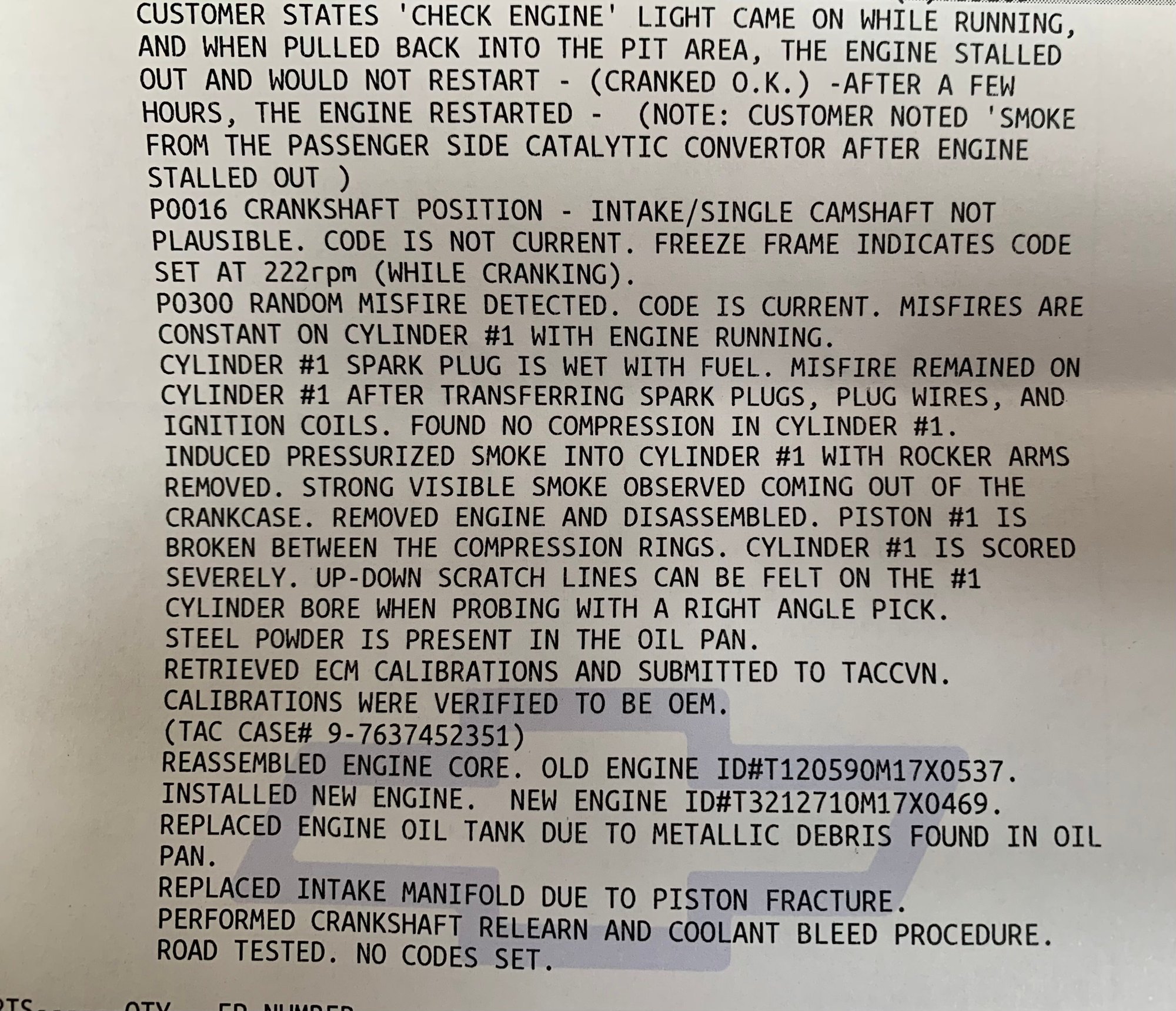

Originally Posted by bobgolub@hotmail.com
This is from the dealer invoice.
They mention debris found but no mention of replacing the oil cooler or even flushing the lines and cooler. Be ready for another engine...
I hope not. I’d like to think they are on their game. I just need it to last until the Z06 arrives, which should be by the end of the year.
Perhaps flushing the cooler and lines is part of the engine replacement procedure (it should be) so it isn't mentioned in the invoice.

I find this part interesting: "Retrieved ECM calibrations and submitted to TACCVN. Calibrations were verified to be OEM."
I've never seen that on a work order before, but it does confirm dealerships check for tunes prior to a major warranty repair.
