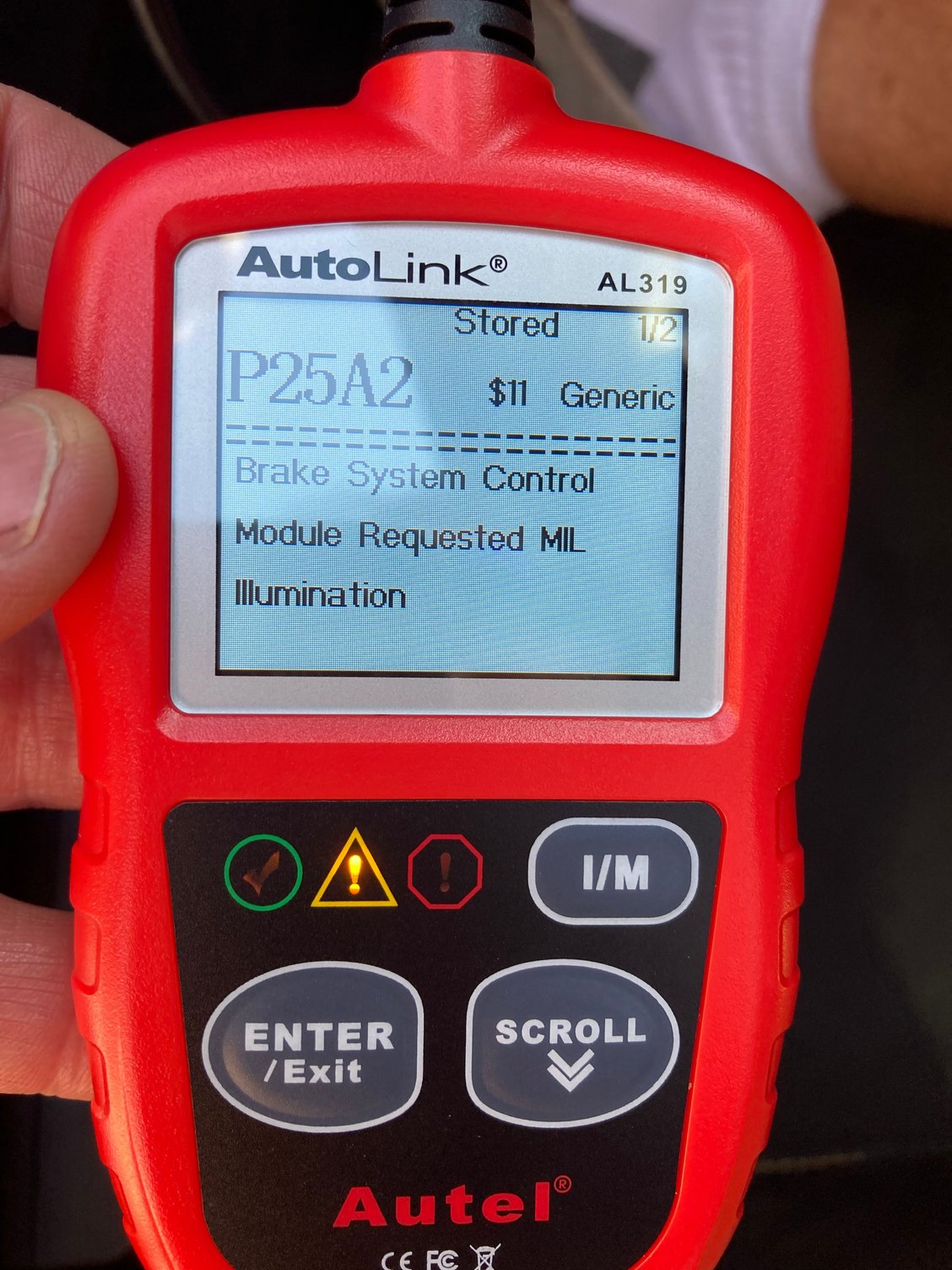

Stock C8
code P25A2

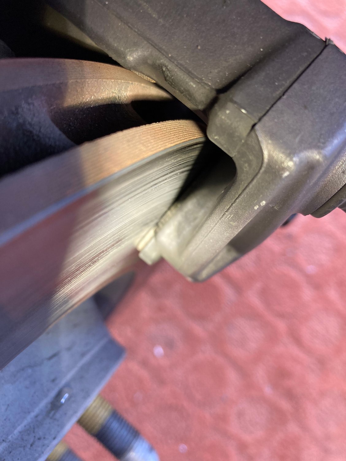

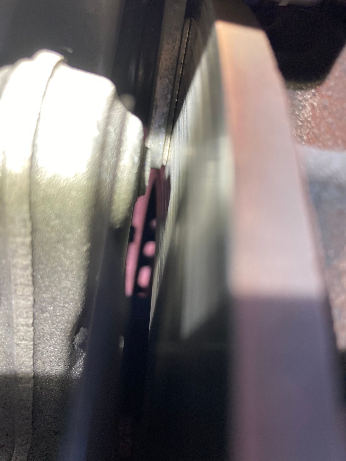

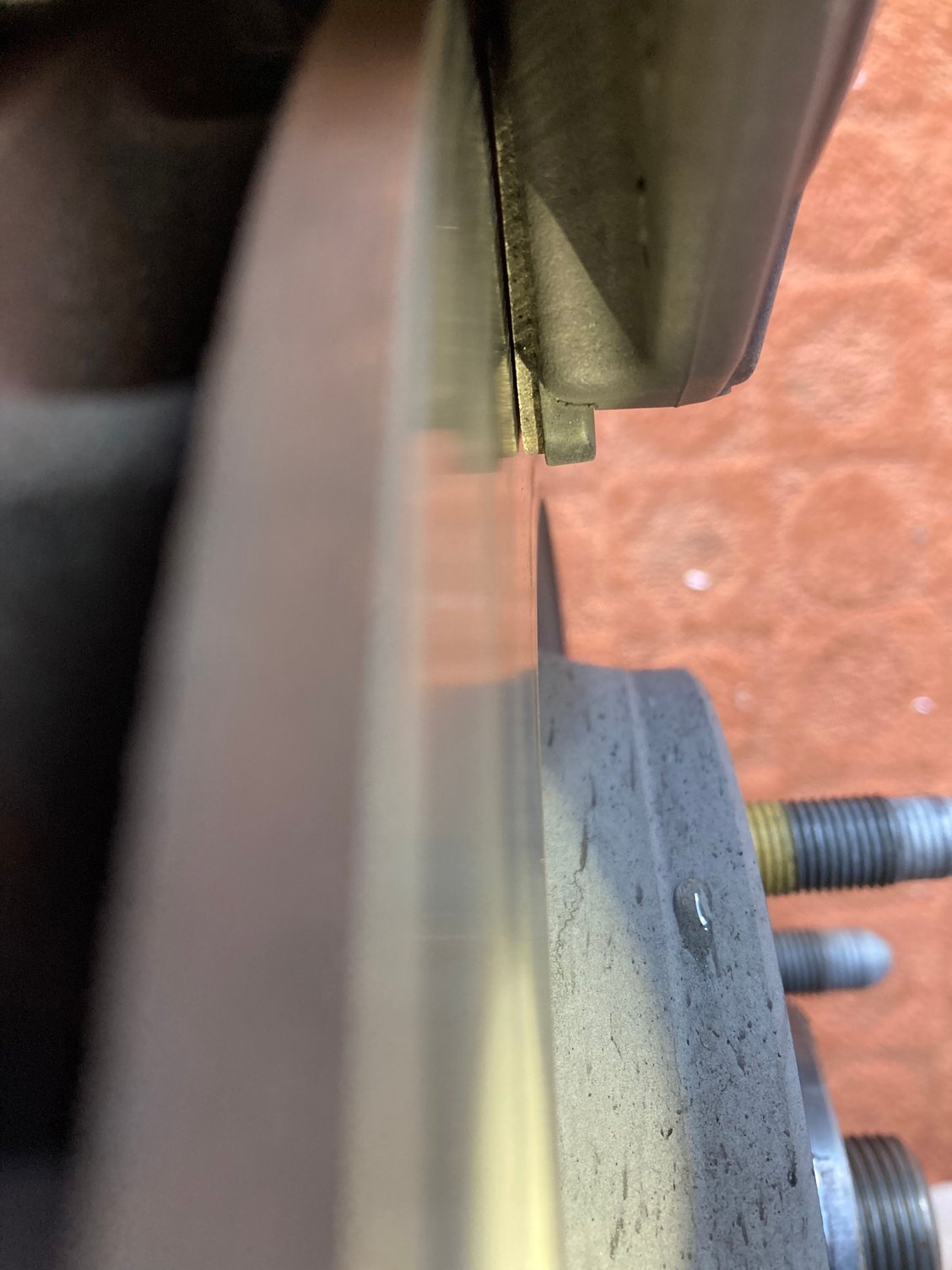

Is it possible the emergency brake activated when the Brake System Failure kicked in? The pads look very close to the rotor and worn down.
It appears the emergency brake pads are very close to the rotor and worn.

Well as expected the idiots at the dealership said my problems were because I was not using the GM brake fluid in the car, which was designed for the corvette. They had never heard of Motul or SFR brake fluid.
They could not explain why a different fluid that I have been using for 8 months with no problem was now causing brake system failure.
My parking brake pads were worn. They said the parking brake engages when the system senses a problem. What?? so I can drive the car at a maximum speed of 43 (Saturday) and 62MPH (Sunday) per the display, while the parking brake is on? I don’t think so.
Their solution was to replace the rotors and bleed the brakes with OEM fluid. Also, since I had changed out the sway bars to larger after market sway bars, I had modified the car and the braking had changed and therefore not under warranty.
Idiots
Idiots
Parking brakes engaged as the car triggered 43 mph max speed after sensing brake problem?! I agree these cars are far more smarter than that.
Larger sway bars affected braking system and voids warranty?! How ignorant can one get?
I hate having to deal with dealership service because of level of intelligent dialog expected. People making stuff up just kills me…
I hope there are other Chevy dealers you can turn to if warranty becomes an issue.
