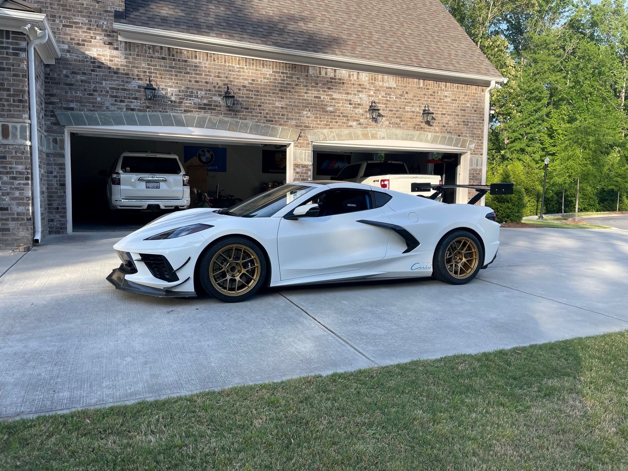

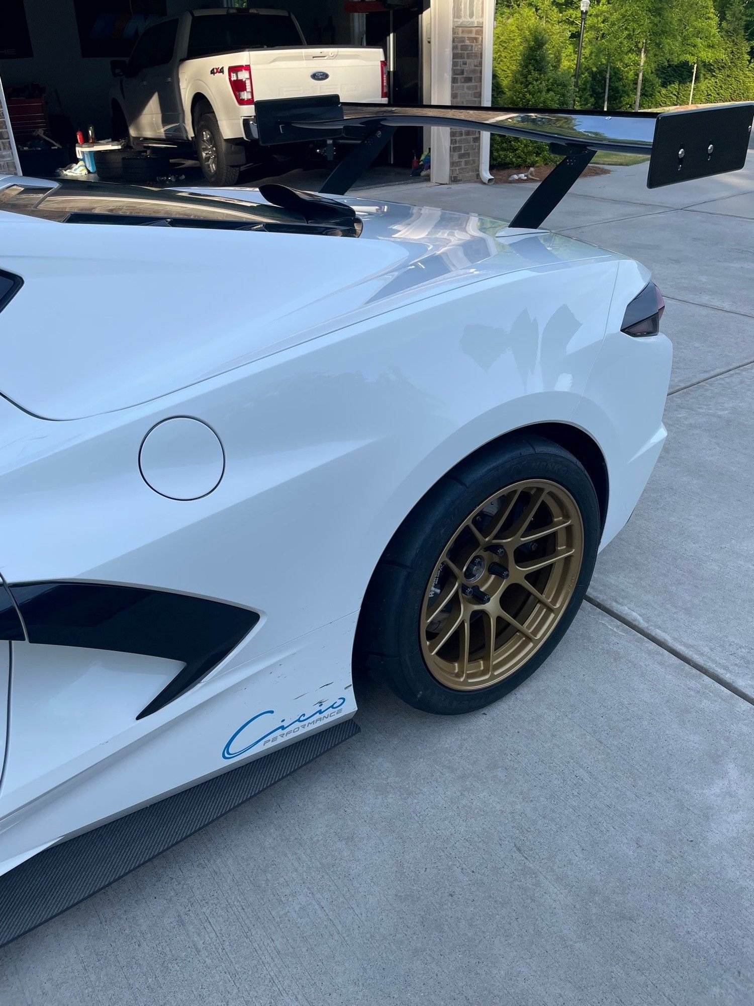

Agree with the above if youre going to be tracking all the time. These will be worth the money and save you money in the long haul as you can use takeoff r compounds
https://cicioperformance.com/product...noblock-wheel/
If you're just going to be messing around pick up a set of oem 5 spokes for 300 bucks and have fun. Ive got three sets i paid a few hundred for and have a street set, rain set, and dry set
