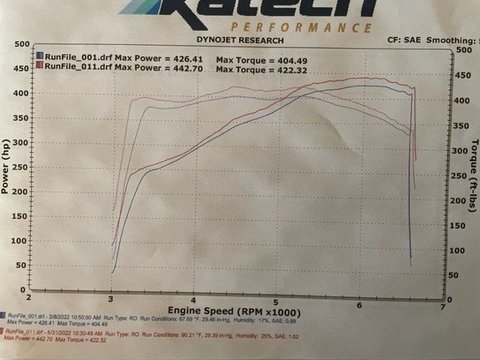

So I went this route with my HTC.
- ARH Headers
- Gateway Intake Manifold
- Katech TB
- Halltech Intake
I'm happy with the NPP, so an exhaust change isn't happening. Gained a nice 16 rwhp /17 rwtq. I really think GM made this a solid car as is. Not much to gain. I'm happy with the results and sound.
Extremely happy with Katech for the installation and professionalism. Thank you.

How is the drivability? Do you feel there is a need for tuning? How was normal fuel economy affected?
There are a number of people here that do not understand how well the C8 takes to mods without tuning due always running in closed loop, except for start up and limp home. No problem with headers and intakes leaning the car to far out.

Consistent gain over the top end (4400 - 6600). How many pulls after the mods were installed did you make? I've seen people gain after a couple pulls as the computer learns the change is permanent.

Really decent gains throughout the powerband. I bet it pulls hard at the bottom end. Just curious, what size TB do you have? Thanks in advance

I don't think tuning will get much more out of this. GM did some good work. And when tuning is available $$$

I really only got on it hard on the expressway on my way home from Katech. I felt no difference up top. Throttle response is instant and my SOP feels amazing.
My buddy has a stock C8. We'll do a 40+ run to see how much it pulls.

4% gain in torque, less than 4% in HP. Going to be hard to tell the difference, I think.

15hp on a 500hp car isnt worth the warranty flag to me

It's 15 RWHP. I know racers that would sell their first born for 1/2 that. I'm not kidding.
