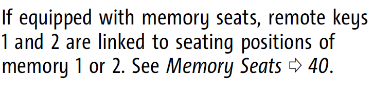

The manual seems to say that memory seat functions are available for keys 1 and 2. I did not see anything about key 3. Did you find anything that says you should have this feature with key 3?

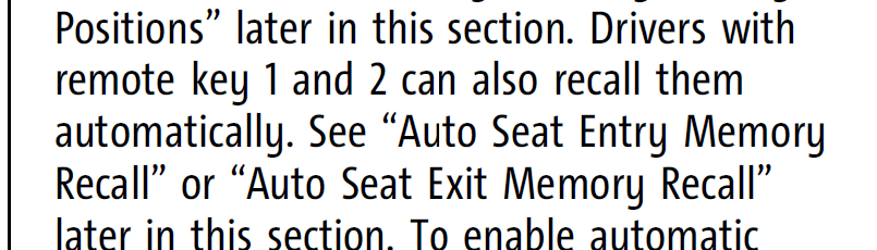

By the way, the above statement from the manual appears to say that any "existing keys must be reprogrammed". That seem to say that the dealer could reprogram the key you have - perhaps without having to buy another new key. But it looks like the dealer needs to do it.
