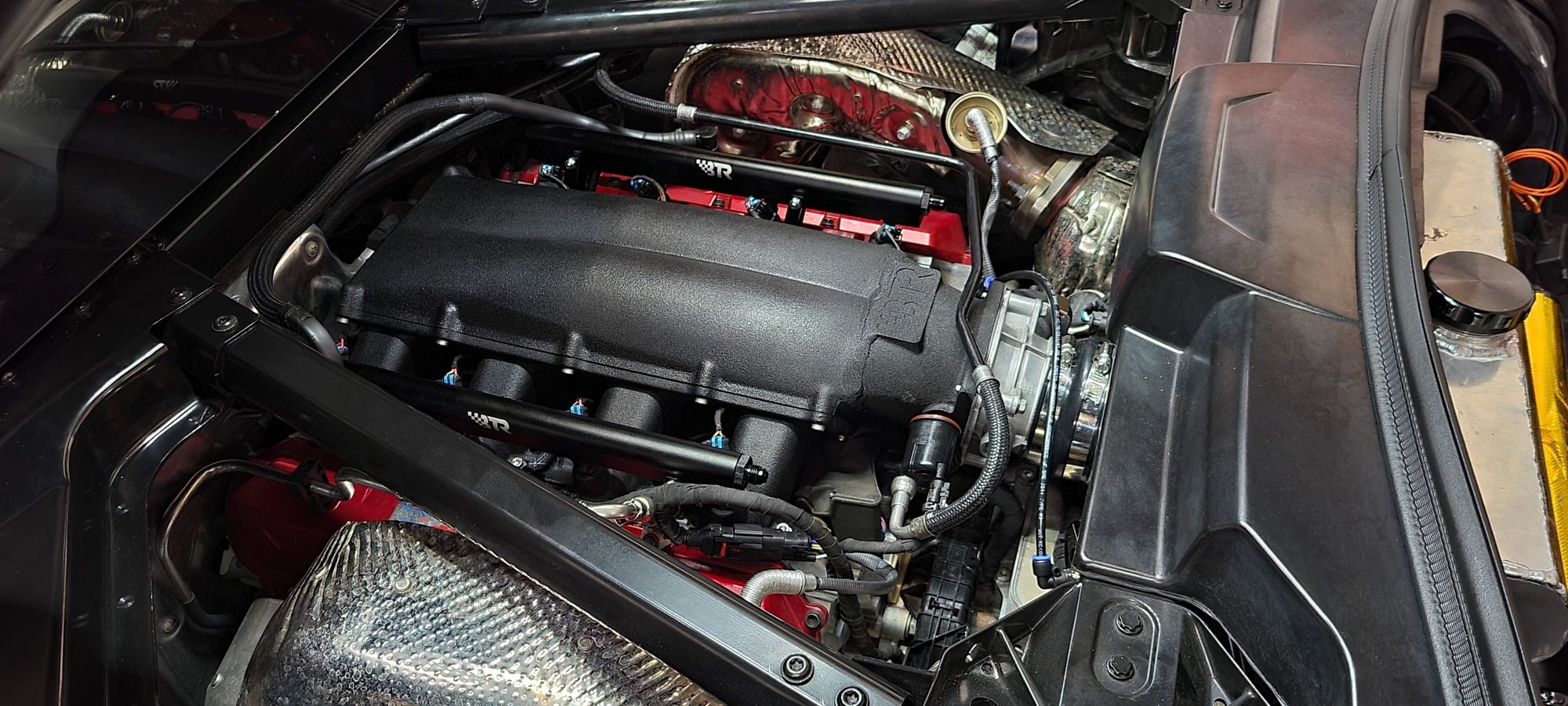

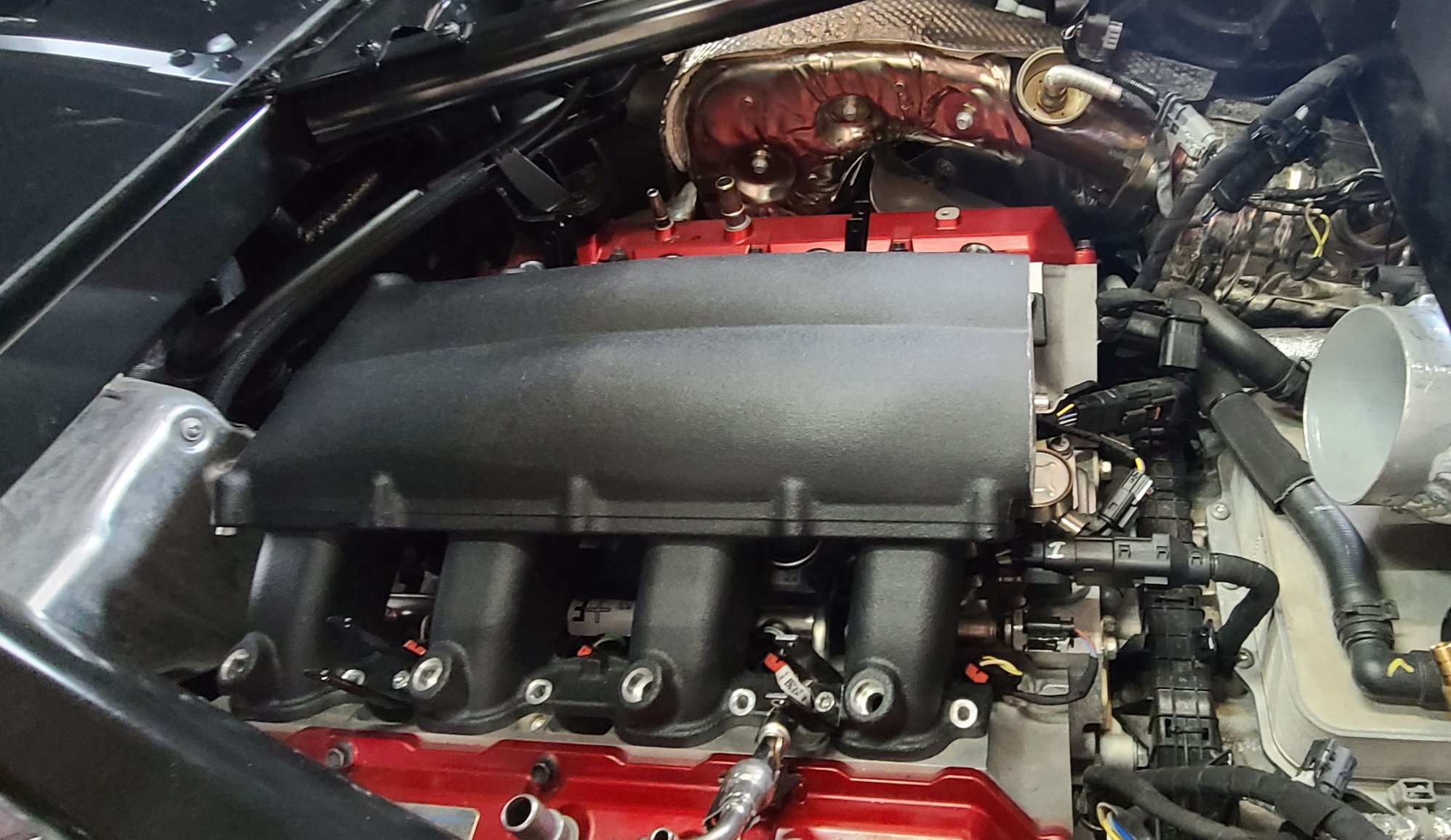

I wanted to answer my own question. I ended up buying a BTR Intake Manifold and fuel rails that go with it.
Long story short, it does NOT fit what so ever.. multiple issues.
1. Factory fuel line is in way, didnt have a chance to try out LT4 fuel line.
2. EVAP solenoid, can not be placed under the intake manifold as they suggest.
3. Bottom of intake manifold hits, high pressure fuel pump and wiring harness.
and biggest issue of it all..
4. Throttle body sticks out about 1" to far and its on wrong angle.
Since I already had it here, I decided to do some cutting/welding to address above issues. Took few hours, but its on there now.. and looking good.
I have few more pics and videos on my IG. @oz_tt_c8
After some cutting..
Test fitting..
All in there now..
