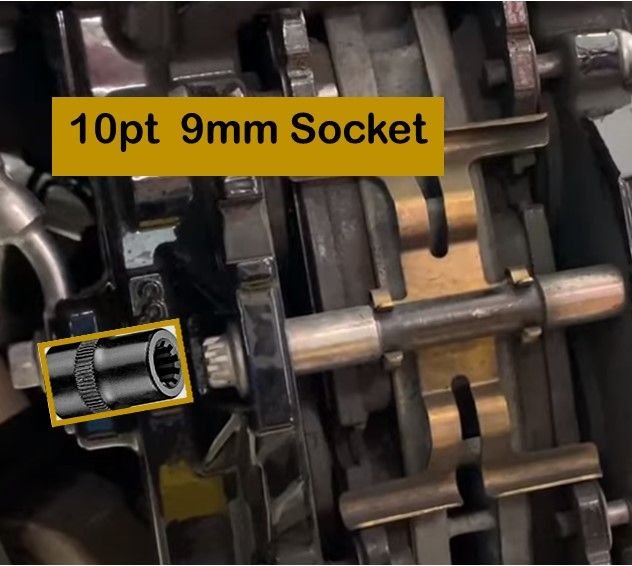

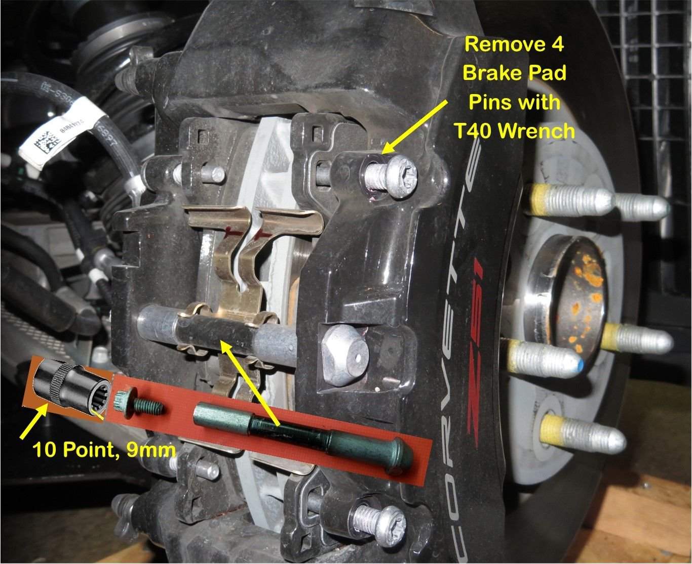

Here are 2 pics from my How Too PDF: http://netwelding.com/Ceramic_Pads.pdf
Only needs this special brake caliper socket used in a number of European cars. $10 on Amazon!
Not much torque required as it's just a small threaded bolt that mounts into a pin preventing caliper spreading when pistons apply load on rotor!

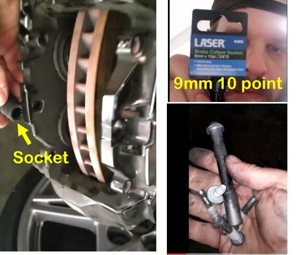

The caliper cross bolt is easy to remove! It's a relatively small screw that threads into the bolt. Yep, you need a special #10 socket as that type of cross brace is on Porsche, Audi etc.
Yep changed a lot of brakes since I was ~10 in 1952, helping my Dad! Have changed brake pads on many cars including my 1st a '41 Coupe I stuffed in an Olds engine, with rear brake drums you had to use a puller to get off the keyway in the axle. Built my current Street Rod with TCI chassis having front and rear disk brakes with the rears from an early Cadillac. It had a mechanical arrangement that activates the pistons with a cable for an emergency brake! Talk about difficult, only made that for a few years but fits the narrowed Currie 9" Ford rear in that tubed 4 bar link chassis! Yep, they are all different- but the challenge is part of the fun!

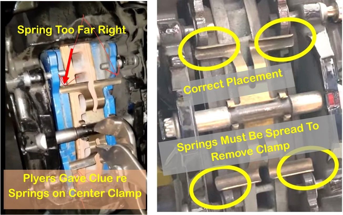

You appear to be saying spreading the center clips on the spring that go around the caliper brace bolt require you to pry them open slightly! Yep, missed that as it's obvious, mentioned in my How Too PDF and pliers work fine to open them slighlty for the room needed. It pulls out fine but to get back does require minor bending the clip. They are a help for those who changed pads by removing the caliper! Holds it in place! They also help keep the spring centered BUT not perfectly, see pic as it can still be pushed too far to one side! As I slipped the caliper brace bolt back in, I just spread them enough to get it through, as my PDF notes. You can, if desired use pliers to close BUT not essential! Mine have worked fine with zero issues for 2 years.
For others viewing this Thread: The center caliper brace slips out after you remove the relatively small screw from one end. Takes a few minutes IF you buy the $10 socket!
Remove the 4 pins that hold the pads in place and the spring just lifts out! install the same way. A poster who used my PDF How Too sent a message saying he used my suggestion of first removing the caliper (as others suggest as well) BUT it is a PIA to get the caliper with pistons, caliper bolt and anti-rattle springs in place. He suggests installing the caliper WITHOUT PADS, CALIPER BRACE OR SPING, then, as I did, slip the pads in, then install the spring, pins and cross brace. That has been my suggestion in my PDF and get lots of Thanks! Note to slip the cross brace in, you have to bend the spring center clips just slightly!
One other note re the spring (covered in my PDF in this pic and as with the ~30+ pics long caption in words) found by a poster. The spring "arms" MUST be placed on the pad metal backing platea and NOT pushed to one side where one pad backing plate is not under the spring "arm!" (Note "arm" is my term) That is where the spring tension must be placed. it's NOT the center spring clips that are critical or where tension is controlled- it's where those "arms" are located!

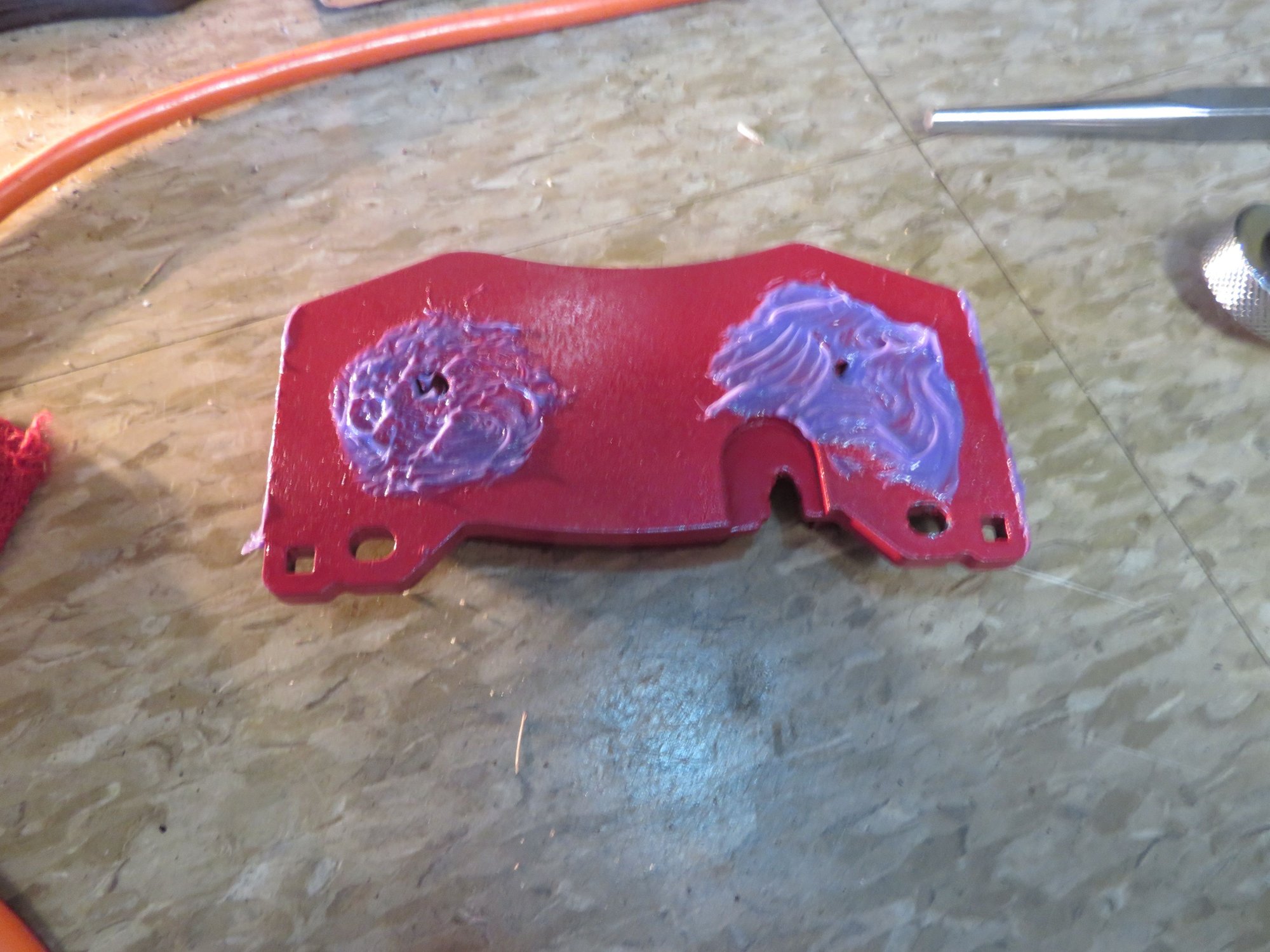

I used this quality high temp ceramic brake lub on the pad backs when I installed Carbotech 1521 Street Pads my C8, as I had when installing them on my 2017 Grand Sport i drove for 4 years and for 3 years with those pads on my 2014 C7 Z51 -NEVER A PEEP.
Put a generous amount on the pad backs where the pistons hit (three each on the C7 Grand Sport 6 piston front calipers. Used the same sparingly on the steel pad back sides as suggested by GM
