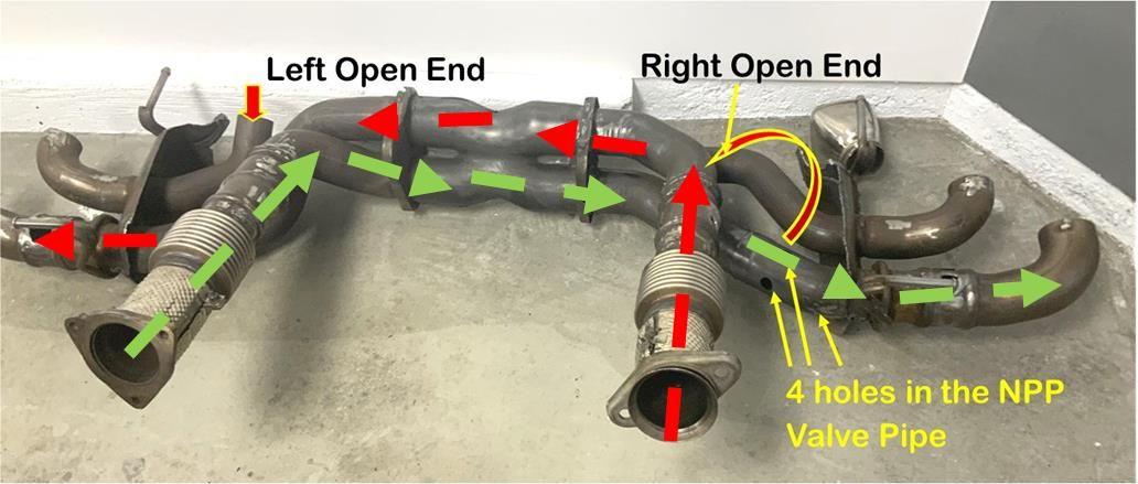

Yep here is a pic that may help:
As you note, the rpm the NPP valves open is dependent on Drive Mode. When NPP valves are closed the exhaust is forced to flow into the muffler (rather than mostly straight out the outer pipes with the NPP valves) and go out only the two center pipes with more restriction and less noise.
