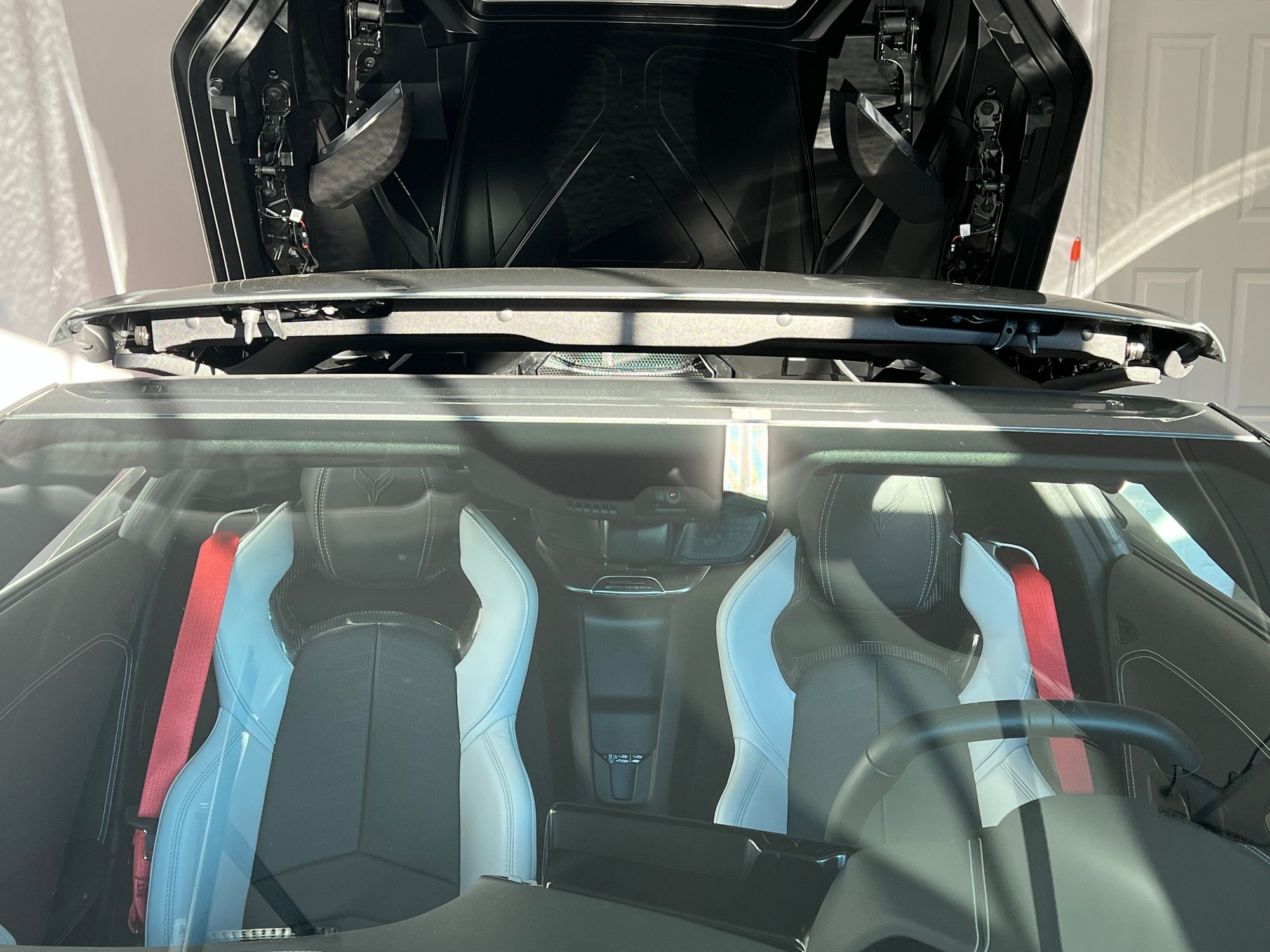

Mine is even, straight and without clunking or shifting. I could not tolerate what you are describing (crookedness).
Sorry about all the morning sunshine and reflections.

RandelB photo is a great shot of what good looks like. Show that to your service provider!

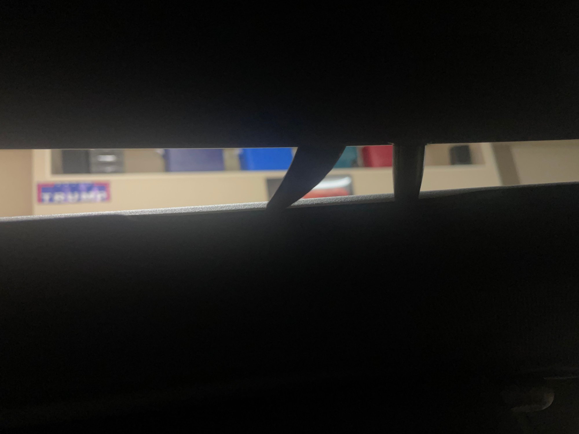

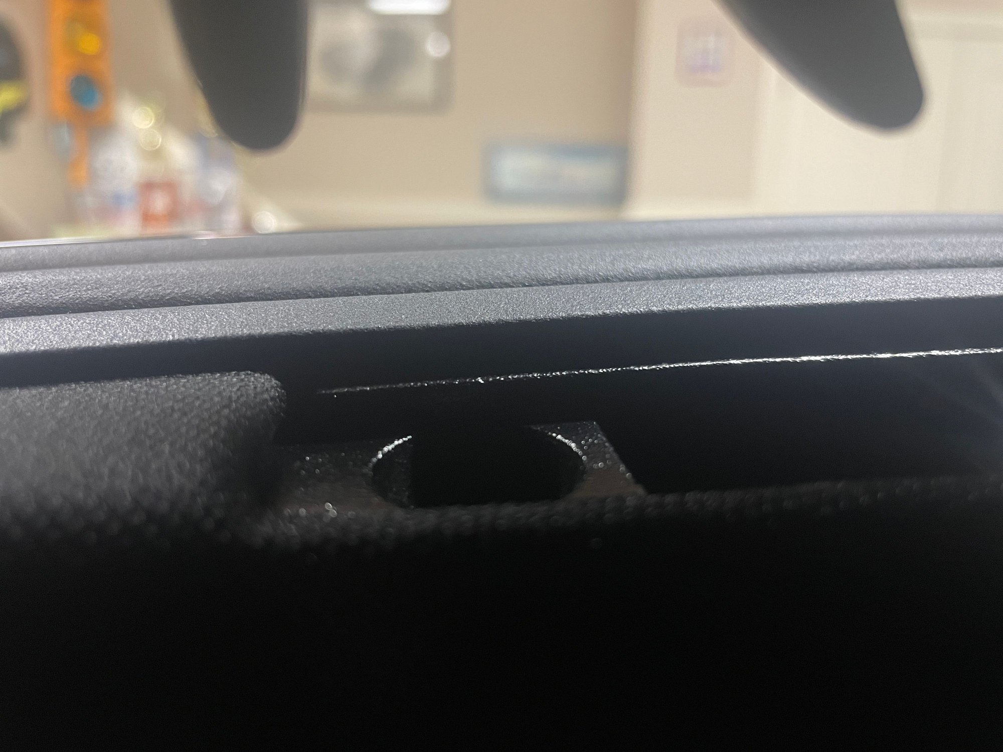

Today I brought my HTC in to have the dealer adjust the hardtop. At the end of the closing sequence the passenger side hits the windshield head liner first with the drivers side following two and one half inches later. I measured the difference. As a result of this difference the passenger side locating pin (the pin attached to the front edge of the top) hits the left side of the mating hole in the headliner, making a banging noise, pulling the top ever so slightly to the passenger side as it centers in the hole, followed by the drivers side pin going into its mounting hole. The top fully closes, the latching mechanisms fully engage and the top snugs down to the windshield headliner with no gaps or other issues. The dealer evaluated this for a day and says this is within the tolerance of the normal operational mode for the hard top. I find this hard to believe. I would like to know if others on this forum who have HTCs experience small misalignments in the top when it is closing. I could probably post a video of this if needed.
Thanks
Did you ever get this resolved? I have the same issue.
driver's side
passenger side
