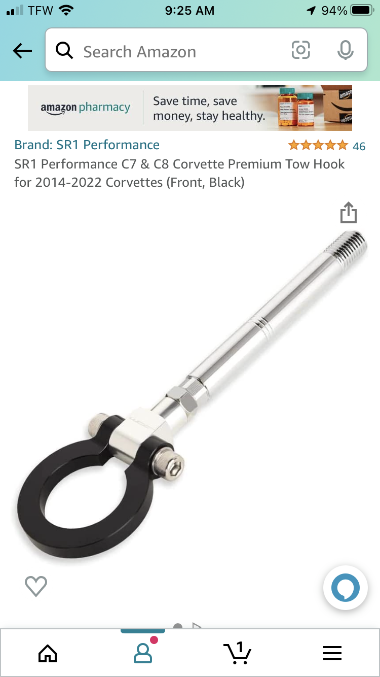

Originally Posted by peter pan
‘Do you have both front and back tow hooks, if so what ones as I am looking to get mine before I vent to the track.
This is what I bought from Amazon
