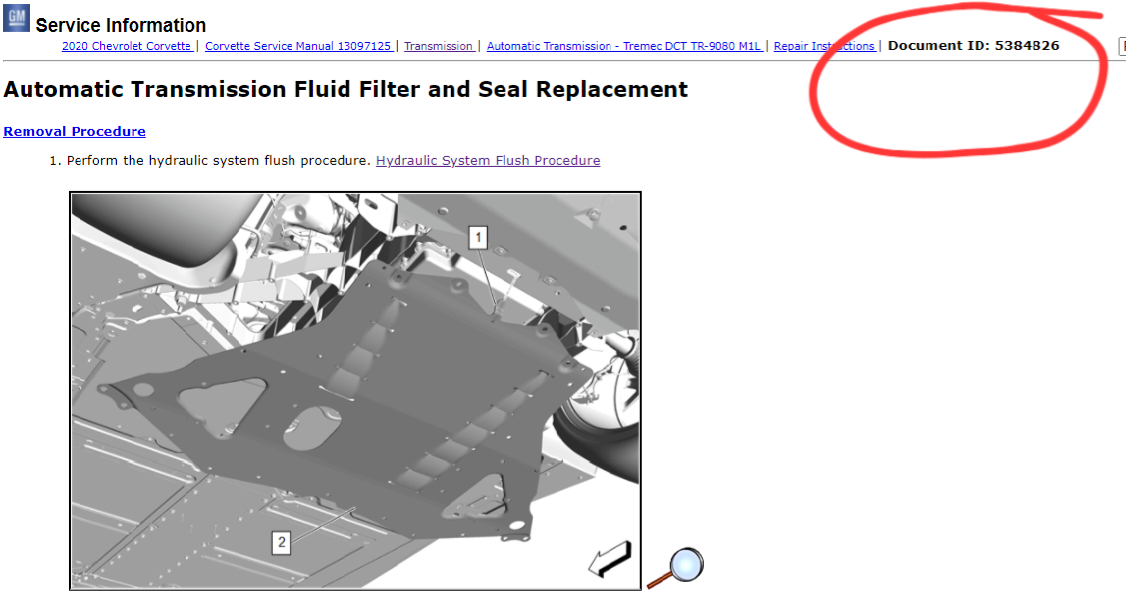

I am at the 1 year point. Hey today! Exactly! what a car. I love it.
A couple months ago I went to the selling dealership which is conveniently only 5 miles away. I talked to the service tech about the strategy of doing my own first oil change and waiting for the 2 year point so that I am closer to the 7,500 DCT filter change. The service writer agreed with the plan and agreed with the extension of the time period of the included oil change and DCT filter change. However he did not know if the DCT filter change included the flush. He asked the service manager and he abruptly and emphatically said NO! it is not included. There was no point in discussing at that point, he still has a year to stand corrected. In the meantime, I have collected procedures and documents to prove that step #1 of a DCT filter change is to perform the hydraulic flush procedure. I am prepared to discuss and walk away if needed if he does not perform the flush.
Document ID_ 5384826 filter chg external cannister
Document ID_ 5659557 fluid flush

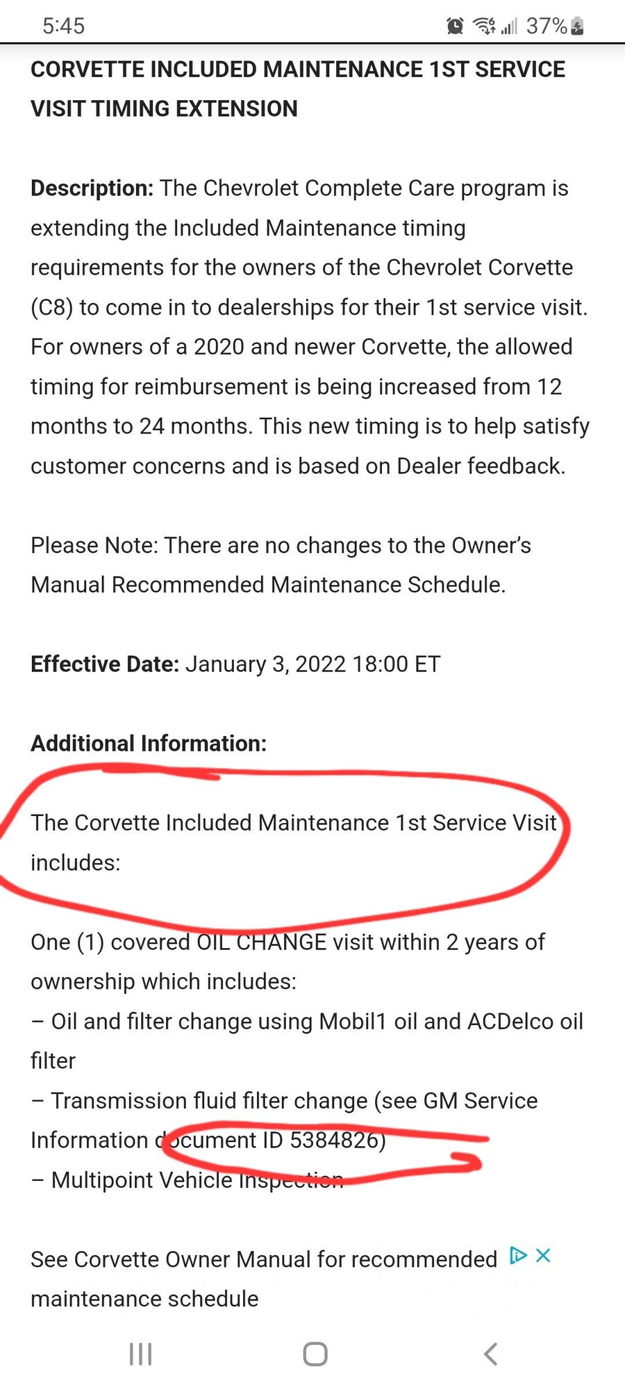

Just wanted to put a bow on this.
For anyone who has a dealership that thinks the hydraulic valve flush doesn't apply to dct filter changes refer them to this ...
Per techlink...
And that document id....
To DCT Fluid Flush Procedure Confusion
