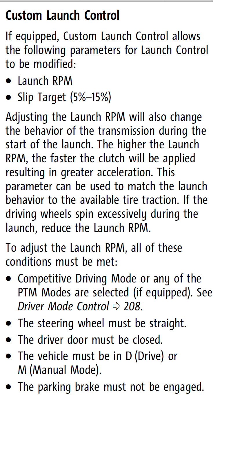

It would be really nice if you could launch at a higher rpm at the track. It would also be nice if you could make the gas pedal less sensitive when just cruising so it would be easier to stay at a consistent speed. I think the throttle controler will allow the second sinario but not the first.

Yes I agree on both counts. The first requires the tcu to be recalibrated (tuned)

I think the following applies to the Z06 - its from the 2023 Owners Manual - and appears to describe some of what you suggest.
