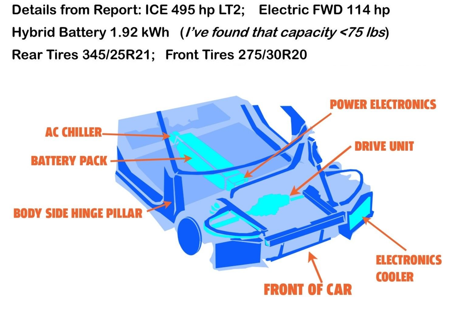

Yep, the E Ray has two back to back ~50 hp electric motors powering the front wheels NOT a driveshaft from the LT2!
Pic from a November 2019 leaked article with E Ray details. I put the details that were in the article on the top of the pic. Some details expanded and reinforced by one of the best automotive writers in SAE International article in 2022 Don Sherman. He mentioned the two back to back motors in the center that is very logical since they can be controlled separately. When exiting an apex need to control power to each side separately.
