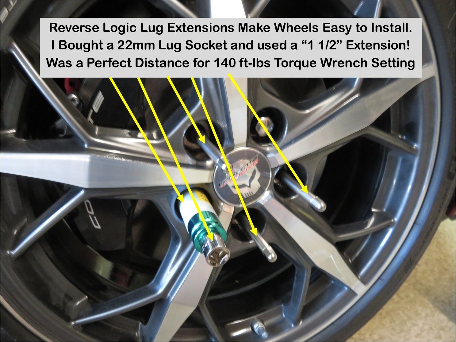

Originally Posted by Elemento Tuning
Some people are able to do it with a small thin flathead screwdriver. As mentioned, you'll need to be careful.
Recall using dentil floss when I removed the Jake center caps from my 2017 Grand Sport before I sold it to put on my C8.
