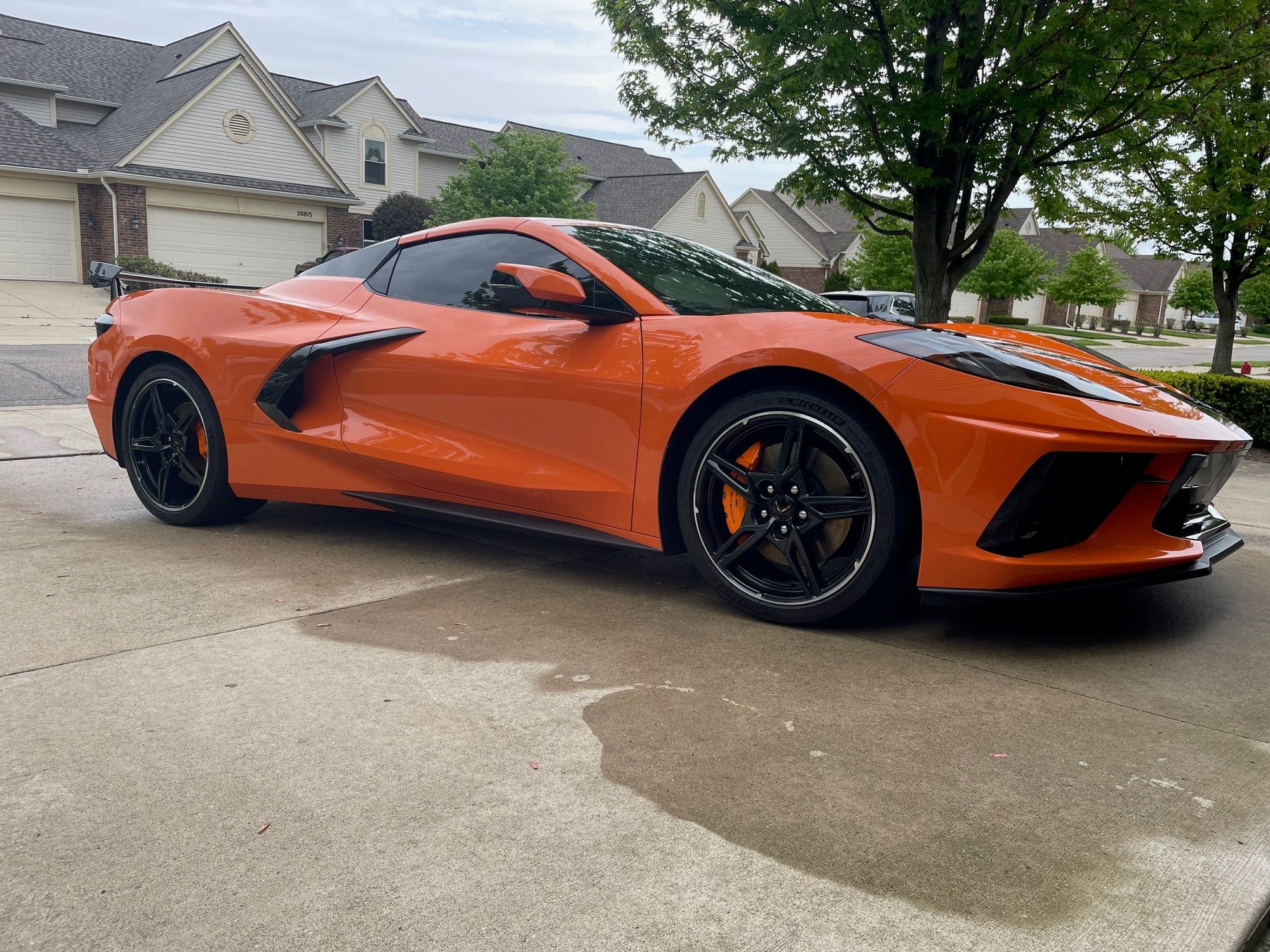

I used TPS Motorsports for my Amplify Orange calipers. I had the dealership put them on.
Why offer black calipers??? We all want to see them.
Good luck!!!

I do track the car a couple of times a year so far. The calipers are ceramic coated, so it washes away the brake dust quite easily.
It really don't matter the color, the Z-51 brake pads produce a lot of brake dust.
What a fun track car!!!
