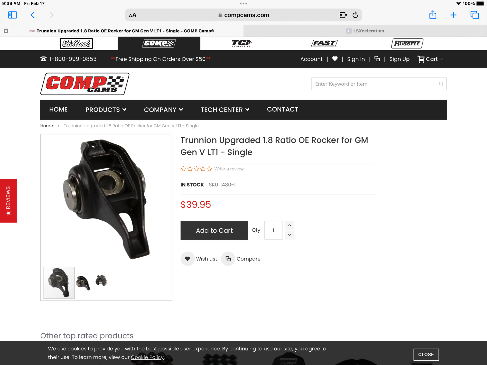

did you ever consider going with a 1.9 rocker arm rather than the 1.8 factory ratio? ,030 increase in lift PTV should not be a issue with no change in duration.

I'm pretty sure the stock rocker is a 1.59 not a 1.8.

That’s for a gen 1 sbc, a gen v lt1, lt2, lt4 uses a 1.80 rocker arm
I thought we were talking about a C8, the rocker arm you posted isn't one for a C8.
Yes it is. LT1 & LT2 are interchangeable here.

Well the one I listed is off the GM Parts website for 2020 thru 2023 C8 Corvette.

well its wrong...
