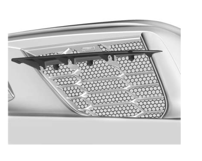

Customcargrills provides a lot of information including the "open area" of the various meshes. Some are as low as 35%, most between 60% and 70% No wonder Tadge was critical of the aftermarket grill protectors they tested. Actually, there was another mesh that had 25% open area, but that one was obviously obstructive to flow. With most of the other meshes, it was not easy to guess what the open area was.
This one is 81%, but of course, it is XXL with 0.45" openings:
https://www.customcargrills.com/prod...d=Perf-Hex-XXL
The next best was a hexagon with .0.25" openings at 77% open area. That would stop a lot more rocks with not much decrease in open area.
https://www.customcargrills.com/prod...?prod=Perf-Hex
That is what they use in the pre-cut grill.

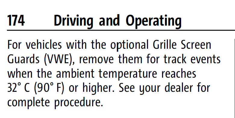

Right. %open area should be one of the first things considered when selecting a screen. While it does not translate directly to % flow (that is 77% open area will not necessarily result in reduction in flow of 23%) there is obviously a relationship between open area and air flow. The screens do restrict air flow. All of them. If you think they don't, check out the clip from the 2023 manual that recommends removal of the gm approved screen for tracking at temps above 90 deg. But, the cooling systems (both Z and non Z) have considerable excess capacity, and thermostatically controlled coolant flow, so in normal driving one is not likely to see any temperature increase caused by screens with 77-81% open area. Screens that become clogged with insect debris will restrict flow and potentially lead to overheating - and that applies to both GM approved screens or the other quality screens with similar open areas. Better to collect on the screen where it is easy to clean, and not on the face of the condenser. Comparing the rock stopping capability of the 0.45 vs 0.25 mesh, the extra rocks stopped by the smaller mesh are the ones smaller than 0.45 in (sort of) but larger than 0.25 in. I wonder how many of those there are?
