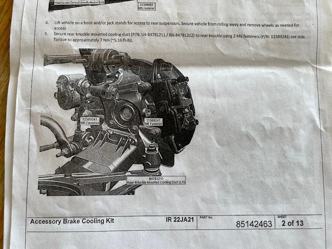

I am looking at the instructions now. I see where it mentions that the rear lower control arm cooling ducts are not to be dealer-installed during PDI [PDI is to skip steps 6-8]. But where, as you state above, do the instructions say you "can" install the upper halves, if desired?
File Type: pdf
File Type: pdf

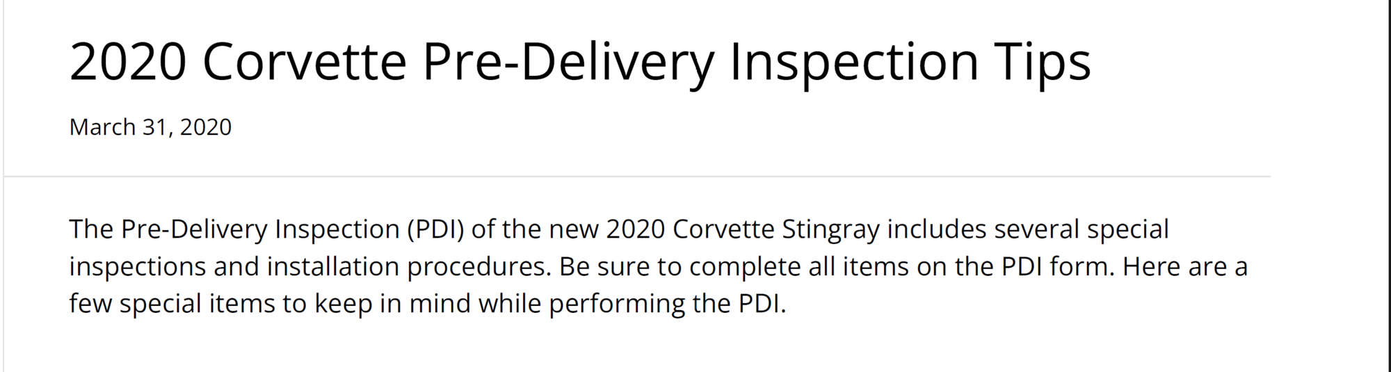

GM tech link : https://gm-techlink.com/?p=12879
"Install the brake cooling deflectors (Fig. 27), except the rear lower control arm brake cooling ducts."
https://www.corvetteblogger.com/2020...e-pdi-process/
it appears that some service technicians skipped the required reading and were either installing everything that came with the car, or installing none of the pieces as required during the Pre-Delivery Inspection."

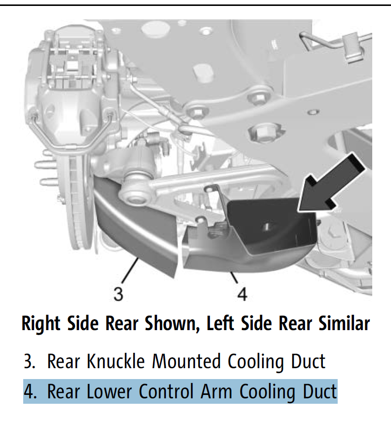

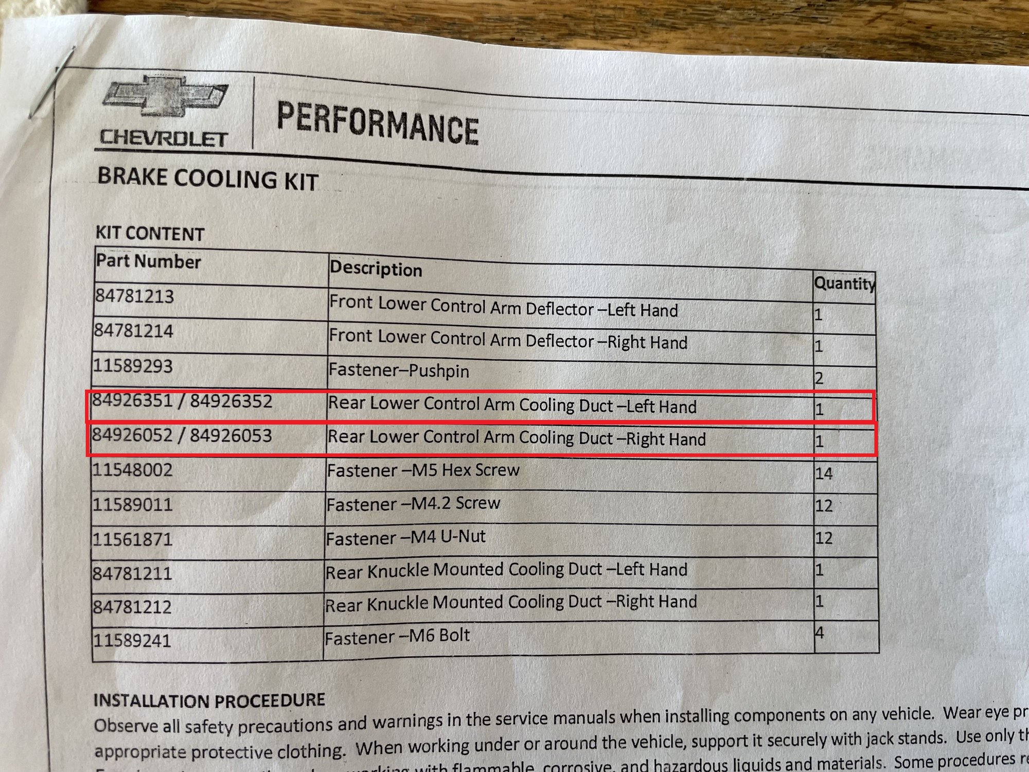

Yes, but there are Rear Knuckle Mounted Cooling Duct LH 84781211 and Rear Knuckle Mounted Cooling Duct RH 84781211 that are dealer installed (in step 5). I have attached also the illustration from the kit instructions showing the installation of the Rear Knuckle Mounted Cooling Duct in step 5 which is part of what the dealer installs.
Start by reviewing the parts list and parts numbers on page on where you will see these parts:
Front Lower Control Arm Deflector LH 84781213
Front lower Control Arm Deflector RH 8478214
Rear Knuckle Mounted Cooling Duct RH 84781212
Rear Lower Control Arm Cooling Duct LH (consisting of two part numbers for upper and lower half) 84926351 and 84926352
Rear Lower Control Arm Cooling Duct RH (consisting of two part numbers for upper and lower half) 84926052 and 84926053
Bottom line is that the dealer is supposed to install the items in green which does include part of the rear cooling duct. You should have 4 parts left in the bag when the car is delivered (the ones in red above). And that is what my dealer, Criswell did.
In the kit instructions, step 2 install LH and RH Front Lower Control Arm Deflectors (part numbers 84781213 and 8478214).
Step 5 installs the Rear Knuckle Mounted Cooling Duct LH 84781211 and Rear Knuckle Mounted Cooling Duct RH 84781212.
That’s it for dealer installed parts. The instructions say steps 6-9 are not dealer installed, and that is where both the upper and the lower halves of the rear lower control arm ducts are installed.

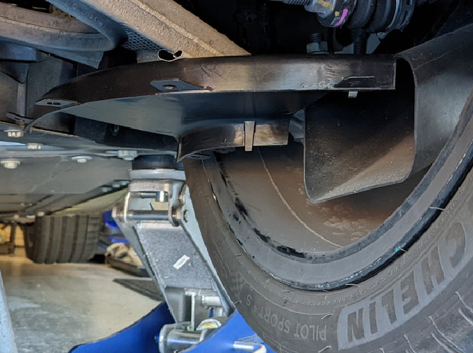

Here is what is installed at the rear for street use. The upper half is flush with the under panels and will not get ripped off nor catch debris that could cause a fire. The lower half is attached for track use.

Yup. What is installed in this picture are the Rear Knuckle Mounted Cooling Duct which is installed in step 5 of the kit instructions, and the upper half of the rear lower control arm duct which is installed in step 7 of the kit instructions. And here is step 7 showing installation of the upper half of the duct.

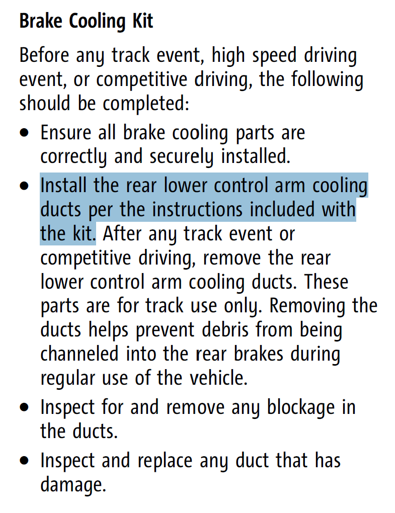

The exact wording in the instructions is "Steps 6-9 below (Rear Lower Control Arm Duct) are not dealer installed for highway use , only to be installed prior to any track use track event or competitive driving. Remove the rear lower control arm cooling ducts after track use." And the parts list shows the the Rear Lower Control Arm Cooling Duct consists of two part, the upper and lower half. The instructions could have said "remove both the upper and lower half", or they could have said "only remove the lower half" for street use, but they don't. And it does not appear that there is any harm in leaving the upper half in place.
It is also consistent with the instructions in the manual, which say "Install the rear lower control arm cooling ducts per the instructions included with the kit. After any track event or competitive driving, remove the rear lower control arm cooling ducts." And the the illustration shows an arrow pointing to part # 4 (which shows the entire duct, not just the lower half of the duct) and the caption refers to part 4 as the "4. Rear Lower Control Arm Cooling Duct". The large arrow pointing to part 4, by the way, is part of the original illustration in the manual - I did not add that. Again, it could have mentioned that the duct actually consists of two parts and both should be removed or that it consists of two parts but only the lower half needs to be removed. But it does not say either one. One thing that is clear is the the Rear Knuckle Mounted (part 3 in the manual) remains in place for street use.
