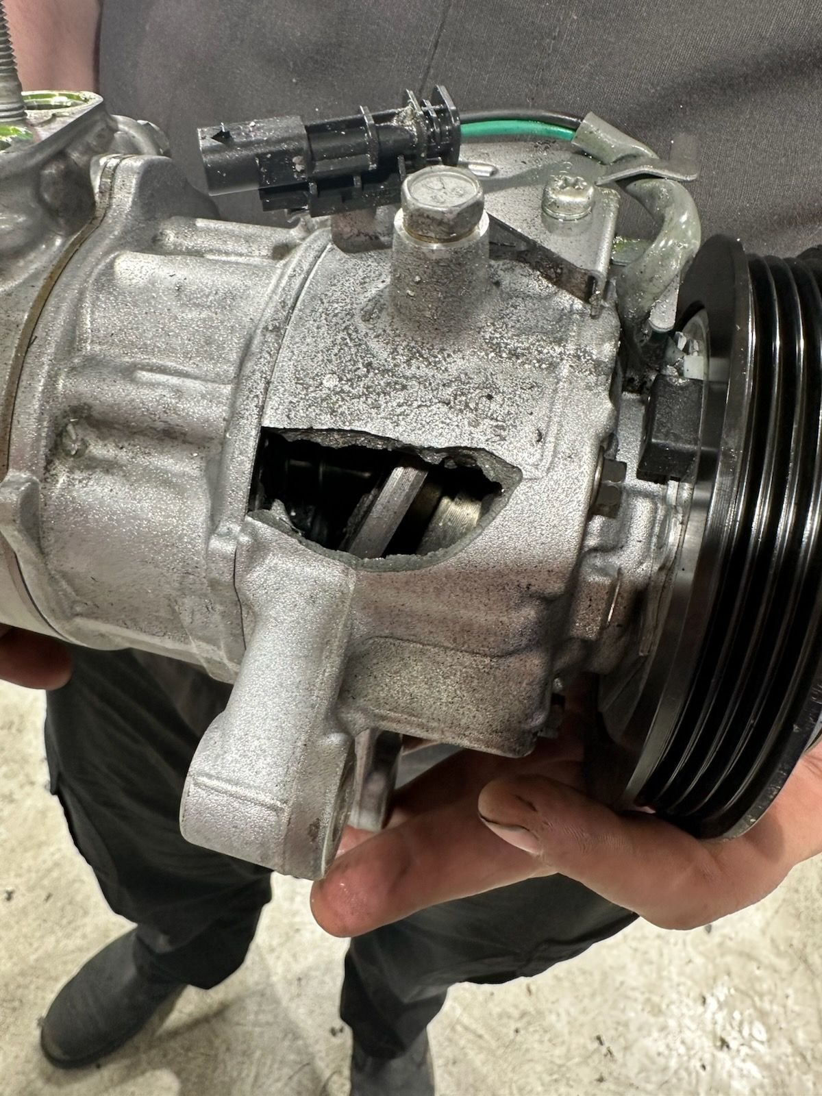

Old Mar 5, 2025 | 05:38 PM
kellyreno's Avatar
kellyreno
Joined: Jan 2024
Posts: 229
Likes: 139
From: South Carolina
Originally Posted by BullfrogRacing93
Have a 2023 c8 with 2015 miles on it that experienced a failed AC compressor. Understanding that the entire system has to be replaced due to contamination. Anyone have some insight or experience on what this might entail? With the mid engine configuration, well, its got me very apprehensive.
Look what happened to mine. 2024 with 5,600 miles. Though I blew the DCT when it happened. Took it in on Feb. 19. Fixed on March 3.
