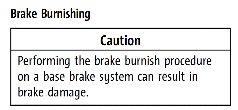

I have a Z51 with 4000 miles and no squeal issues.
The manual says some" driving conditions or climates can cause a brake squeal when the brakes are first applied, clearing up following several applies." It says nothing about needing to do hard braking. It does state that "anti-squeal paste is applied from the factory and will dissipate over time. To help reduce squeal, the brake pads are treated with an anti-squeal paste that may need to be reapplied periodically as part of normal vehicle maintenance. The anti-squeal paste will dissipate over time. Also, the use of wheel cleaners or power washers directly on the brake calipers may remove the anti-squeal paste from the brake pads. It may be necessary to reapply the anti-squeal paste if it is removed during cleaning. If brake squeal is excessive, the anti-squeal paste should be reapplied."
The brake burnish procedure is not recommended for the non-Z51 car which you have.
For the Z51 a burnish procedure is recommended in preparation for track events or competitive driving, or for corrosion clean-up if the car sits for an extended period of time, especially in a high humidity environment. I see nothing in the manual about a periodic burnishing procedure being necessary.
It sounds like you have tried the right remedies. I don't have a solution, but you should not have to get different brake pads. There are very few reports of excessive brake squealing for the C8.
