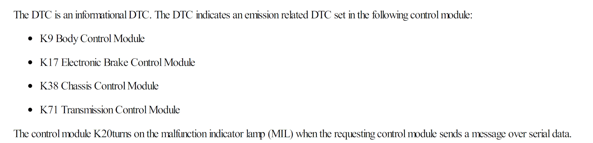

Do u have any insight on the P0700 code? Thx

I do not think that is a specific failure. Rather, it indicates a request from another module to turn on the light on the DIC. I think there is typically, and maybe always, another more specific DTC associated with it. Some DTC will not result in setting of the CEL on the DIC. They call it a Malfunction Indicator Light (MIL) in the version of the service manual I have. It also describes it as being "emission related" . It is the same as the Check Engine Light. On page 86 of 2023 of the Owners Manual it is described as "Malfunction Indicator Lamp (Check Engine Light) and it also describes it as "emission related".
